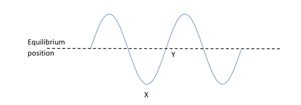

Question 3; I have also attached the diagram to this question.
The diagram exhibits a wave on a rope at an instant in time. At this point in time, X is at its maximum displacement and Y is at its equilibrium position. Which describes the motion of points X and Y as the wave moves to the right?
a. Y rises, X falls
b. X rises, Y falls
c. Y rises; X is at rest
d. X rises; Y rises

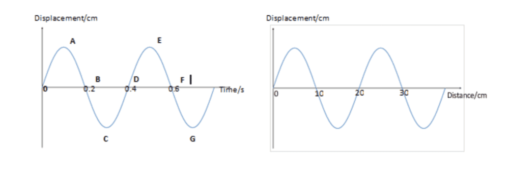

Question 5; I have attached a diagram tat is intended to be used for all aspects of this question.
i. Identify the points in anti-phase
a. (O & B), (D & F), (A & E), (C & G)
b. (O & B), (B & D), (D & F), (A & C), (C & E), (E & G)
c. (O&D),(B&E),(D&E),(C&G),(G&F)
d. (O, B, D & F), (A, E, C & G)
ii. Identify the points in phase
a.(O & D), (A & E), (C & G), (B & F)
b.(O, B, D & F), (A, E, C & G)
c.(O, B, D & F), (A & E), (C & G)
d.(O & B), (D & F), (A & E), (C & G)
iii. Identify the points with a phase difference of π / 2
b.(O, A, D & E), (B, C, F & G)
c.(O & B), (B & D), (D & F), (A & C), (C & E), (E & G)
d.(O & A), (A & B), (B & C), (C & D), (D & E), (E & F), (F & G)
iv. Calculate the wave speed
a.50 ms-1
b.0.5 ms-1
c. 0.25 ms-1
d. 8 ms-1

Question 3; I believe that the correct answer is d, X rises and Y rises as the wave oscillates to the right the positions of X and Y will both increase originally as they travel to the wave peak. As the wave continues to travel, the positions of X and Y will respectively fall as they follow the trough of the wave and so on.

Question 5;
i.For sinusoidal signals, when the phase difference 180° or rather
\pi
radians the phases are opposite the waves are said to be in antiphase. Hence I think that the correct solution is b. (O & B), (B & D), (D & F), (A & C), (C & E), (E & G)
ii. When two points are in-phase they are separated by a complete wavelength, thus I believe the correct answer is a. (O & D), (A & E), (C & G), (B & F)
iii. A phase difference of π / 2 radians would occur at (O & A), (A & B), (B & C), (C & D), (D & E), (E & F), (F & G), choice d.
iv. Wavelength is shown to be 20cm=0.2m
Frequency = 0.4s to produce 1 wave. In 1 second; 1/0.4=2.5 waves produced per second, therefore, there will be a frequency of 2.5 Hz
v=f*λ
v=2.5*0.2
v=0.5 ms^-1 (choice b)
It doesn't "oscillate" to the right, it moves right. Superimpose the same wave moved a bit to the right. Does it now pass below the point marked Y or above it?

@haruspex Thank you for your reply and I apologise for not replying sooner I have not been on the PF for a while. Regarding question 3 I think from what you have stated to imagine superposing the same wave to the right the wave will rise at Y but remain at rest at X?

Were my answers for questions 5 and 6 correct?
Seems to me that Y will fall, but that combination is not listed.
Yes, 55Hz for 4, and I agree with all your answers for 5 and 6.
