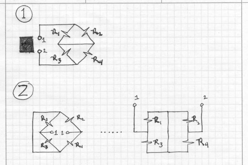

This is more of a concept question rather than a HW problem, but I have two Circuits shown in the image attached. I am not really understanding how a short would affect resistance in these cases.
2. The attempt at a solution
For figure 1 I am considering one of two possibilities:
1) Req = (R1 || R2) + (R3 || R4)
2) Or there simply is no equivalent resistance b/c the entiretly of the current wants to travel down the short and this creates a contradictory circuit
And for figure 2 (redrawn to the right) I am considering one of two possibilities:
1) Req = (R1 || R3) + (R2 || R4)
2) Or there simply is no equivalent resistance b/c the entiretly of the current wants to travel down the short and this creates a contradictory circuit (same as above)
Anyway if anyone could point me in the right direction that'd be great.
-Thanks!

I'd say your 'redrawn to the right' fig is 1, not 2 redrawn.
I have not met before the notation you are using but it seems fairly self-explanatory and it looks to me 1.1 is right.
A short means the two nodes connected by it are at the same potential, so it will be clearer to you if you redraw (even mentally) with the shorted nodes fused into one, then it's very simple I hope.
For 2 I understand the nodes are not connected at the 'waist'. So then you have one branch with two in-series resistors and its resistance is their sum, then the same on the other side...

thanks for the quick reply.
So for figure 2 the resistors I have circled in blue would be in series?
correct
correct
When schematic is not clear, keep redrawing it until it becomes clear. This may take multiple trials. Do not draw multiple parallel connecting wires; combine them into one wire.
no they would not be
no two resistors are in series here
there are two pairs of resistors, each pair contains two resistors in parallel, the two pairs are then in series
Figure 1 and 2 are the same, only the subscripts for which resistors are parallel will change, otherwise the basic structure of the circuit in both cases is the same
