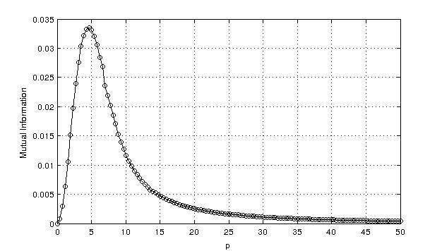

Further, to this question I would like to ask for some more details please regarding the interpretation of a mutual information graph. As mentioned in all replies: "the product of marginals is the joint under an independence assumption. Comparisons between the joint and the product-of-marginals distributions can be useful in identifying "just how" dependent two random variables are. For instance, in information theory, the "mutual information" of two distributions (a measure of how much each tells us about the other) is attained by taking the relative entropy of the actual joint distribution, with respect to the product-of-marginals distribution."
I have now computed the mutual information (MI) by using the appropriate formula. I have varied one of the parameters of the distribution and performed the integration numerously. Therefore, I have computed the MI for various values of that parameter (say p) so that I can later plot MI,p and observe the result. Please find attached the graph I obtained. It looks-like a skewed distribution and the question now is how does one interpret this graph? What can we say about it? How much information does the joint in comparison to the product of marginals share? We see that for large values of p the MI reduces significantly. Perhaps, this indicates that for large values of p a good approximation is achieved by the product of marginals. Any other hints? Also, the MI goes up to 0.035 (for smaller values of p) which is a small value but relative to what? For example, this maximum value (0.035) may be relatively small fro practical purposes and therefore the product of marginals may give an acceptable error.
Thanks once more for your time in reading this. Please see attachment mi.jpg. The logarithm base was set to 10.

There is always a difficulty in real life situations defining what is meant by a "small" or "large" error and also defining how "error" is measured. With information theory, there is the added problem that "information" (as far as I can tell) is not a universal property of an real life object or situation (such as mass or temperature).
For example, suppose we randomly select a number according the following probabilities
p(1) = 0.3
p(2) = 0.2
p(3) = 0.5
Suppose we win the following amount of money as a function of the number selected
1 wins $5
2 wins $5
3 wins $100
The entropy of the probability distribution for the numbers is not the same as the entropy of the probability distribution for the winnings. If the rules for the amount won were changed to
1 wins $5
2. wins $5
3 wins $6
Then there seems to have been a fundamental change in the situation, but this is not reflected by any change in the entropy of probability density function for the amount won.
So I can't make any useful interpretation of a mutual information graph or what it implies for "good" or "bad" approximations. The first step would be to define how you intend to measure "error". For example is the "true" values is x and the "predicted value" is w, will the error be measured by (w-x)^2 or | w - x | or perhaps some more complicated "payoff" or "penalty" function of w and x?
Dear Stephen,
thanks for your reply. Your question with regards to the measure of error I think is answered by the mutual information itself, since the mutual information can be expressed as the Kullback-Leibler divergence, indicating the "distance" between two distributions. My intention is to give a measure of the distance between the two distributions so that one can conclude that under certain parameter settings the assumption of independence may or may not be claimed. Such is the case in the previously attached figure for p=5, where maximum mutual information is shared, albeit the obtained value is small.
As a last thought, to provide insight into the relativeness of the 0.035 value that corresponds to p=5, I thought of comparing this with the entropy of one of the random variables comprising the joint distribution.
If you think that this makes sense, then please let me know.
I don't recall your explaining the distribution for which p is a parameter and whether the plot is a result of computing or simulation. At any rate, it isn't clear what mathematical problem is posed by you goal to "conclude that under certain parameter settings the assumption of independence may or may not be claimed". If you mean that when the mutual information between two variables is zero then you can say they are independent, that's true. If you have some idea that a mutual information that is "small" implies the two variables are "nearly" independent, you have to give some critera for what "small" and "nearly" mean. If the plots you make are from statistical sampling and you want to do some sort of statistical "hypothesis test" to "accept" or "reject" the idea that the two variables are independent then this is yet a different type of mathematical problem.
I understand the plot shows mutual information vs a parameter, but I are you saying that you wish to conclude something about the two random variables based on the maximum mutual information, which is the value produced at p = 5?
"Comparing" is a mathematically ambiguous term. It could mean taking a ratio or a difference or simply looking at which of two things is greater. I also don't know what judgments are to be made on the basis of this comparison.
Yes, p is a parameter of the distribution and the plot is the result of computing and not simulation.
If you have some idea that a mutual information that is "small" implies the two variables are "nearly" independent, you have to give some criteria for what "small" and "nearly" mean.
This is exactly what I am trying to achieve. This is the reason that I proposed the comparison with the entropy of one of the random variables, in order to give some criteria for what "nearly" independent is in this case; to give a measure of the extent of "correlation" between the two.
I understand the plot shows mutual information vs a parameter, but are you saying that you wish to conclude something about the two random variables based on the maximum mutual information, which is the value produced at p = 5?
Yes, this is exactly what I mean.

As far as I know, there are no mathematical results that establish any "standard" scale for mutual information that defines what "small" differences are or what "nearly" mutually independent means. It's similar to the case of evaluating a procedure to approximate a function or an area. The mathematical results concern limits, they don't establish that .001 or .0000001 is a "small" number or even that .0000001 is a "small" percentage. The question of what constitutes a "small" amount depends on the practical application.
If you are willing to stipulate what a "small" probability is, then it might be possible to find a result that falls in the pattern:
Let X and Y be random variables with a joint distribution that is in the family of distributions given by f(X,Y,rho) where rho is a parameter. Let g(X,rho) and h(Y,rho) be the respective marginal densities.
If the mutual information between random variables X and Y is less than Delta when rho = rho_zero then the probability of the event { (x,y): such that | f(x,y,rho_zero) - g(X,rho_zero) h(Y,rho_zero) | > .04 } < Delta^2.
Off hand, I don't know of any such results, but that type of result would connect information to probability.
To repeat what I said before, I see no way to establish an absolute scale for information that works in all practical applications. For example Let X be the area of one face of a cube. If X is uniformly distributed on the interval [1,4] then the distribution of the side of the cube is not uniformly distributed and the distribution of the area of the cube is not uniformly distributed. The three distributions have different entropies. Unless a person specifies which quantity ( length, area, volume) is of concern to him, there is no way to establish which entropy has practical significance.
When you deal with discrete distributions, you avoid the above problem. For example, if the area of one face of a cube can only have the discrete values 1 or 4 and each has probability 1/2, then the probability distributions for the possible sides and volumes, each have two possible values with probability 1/2.
