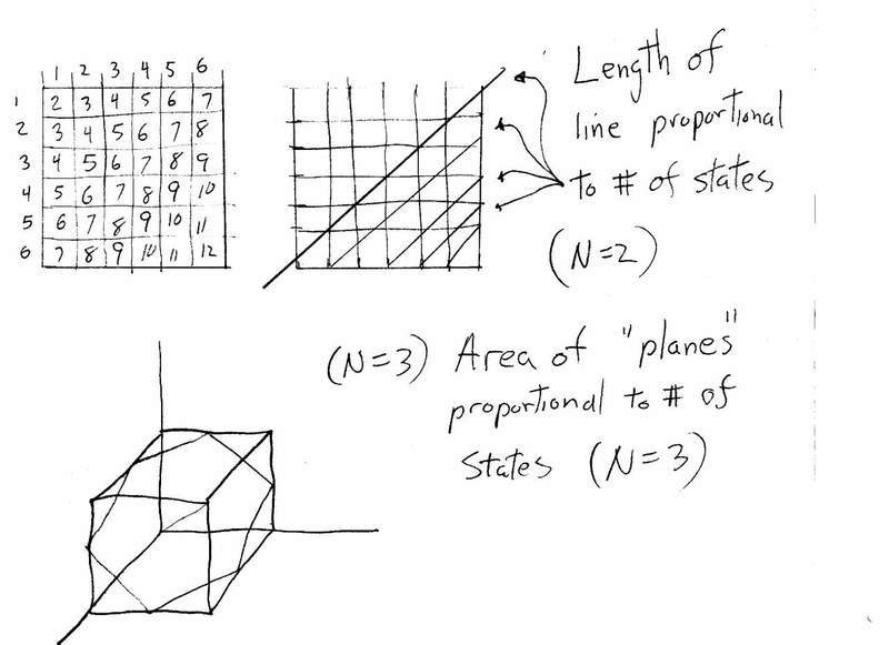

For large N I think there is a geometrical solution to this, see the attached.

This problem is pretty hard and I think post #3 has the right idea. Perhaps it is easier to calculate the "volume" under the bounding surface (In N = 2, "volume" is area and "bounding surface" is a line) and then you can differentiate w.r.t. n). Your problem will be to evaluate N-dimensional volumes. I think you can use some recursion.
