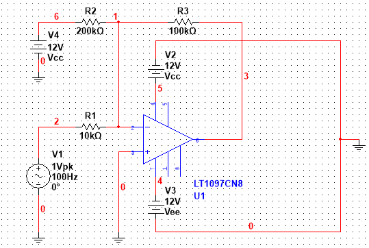

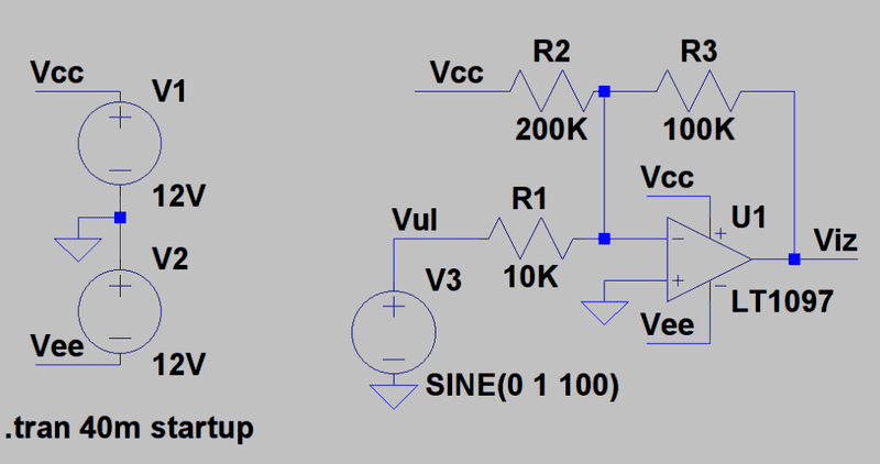

Hi. I have problem simulating this circuit in Multisim:
(LTSpice)
Here is scheme from Multisim:
When I run transient analysis, I got this:
------ Checking SPICE netlist for Design3 - Saturday, September 26, 2015, 10:58:03 AM ------
======= SPICE Netlist check completed, 0 error(s), 0 warning(s) =======
Transient time point calculation did not converge
Simulation canceled
Any idea what's wrong? Thanks in advance

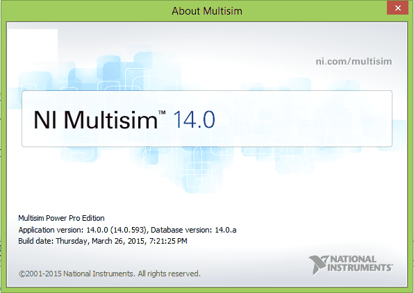

I tried different models of opamp and I got same error. Here is my version of software:
cut v4 and v1 in half or set to 0 just to see what happens. Add a 10k to ground on the output to see what happens.
Do you get a stable dc operating point?
Have you tried AC analysis?
Likes etf
Solved, I didn't connect power supplies to op amp correctly :)
