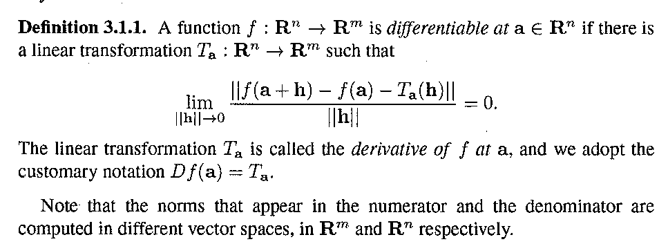

I am reading Andrew McInerney's book: First Steps in Differential Geometry: Riemannian, Contact, Symplectic ... and I am focused on Chapter 3: Advanced Calculus ... and in particular on Section 3.1: The Derivative and Linear Approximation ...
I am trying to fully understand Definition 3.1.1 and need help with an example based on the definition ...
Definition 3.1.1 reads as follows:
240744
I constructed the following example ...

... can I take ##T_a (h) = T_a.h## ... but how do I justify this?Hope someone can help ...

It has what I think is a typo: ## −|T_a(h)| ## should be outside the expression and without an ## ||h||## below it. ## \\ ## Was denkst Du (German) @fresh_42 ?, i.e. might you have an input here? I think the author goofed. ## \\ ## ## T_a (h)=(2,3) ## as ## h \rightarrow 0 ##. Again the author goofed. All this requires is a simple knowledge of calculus to see the author goofed. ## \\ ## I could be wrong, but I think I have this correct here.
First, in your example, ##h \in \mathbb{R}## so you can write ##|h|## instead of ##\Vert h \Vert##.
You are looking for a linear transformation ##T_a## such that ##\Vert (2h, 3h) - T_a(h) \Vert/ |h| \to 0## when ##h \to 0##.
In this case it is quite easy: we can simply make the numerator ##0## for all h such that the limit will be ##0## as well.
Simply pick ##T_a## the linear map defined by ##T_a(h) = (2h, 3h)##.

The definition is perfectly fine. It is the same one as Rudin, Apostol and Spivak use in resp. Principles of mathematial analysis, mathematical analysis and calculus on manifolds.

Also, ##T_a(h) = (2,3)## is no linear transformation. It does not send ##0## to ##0##. It should be ##T_a(h) = (2h,3h)##, as in post 3.
Are you maybe confusing the matrix and the linear transformation? Some authors define the derivative to be the matrix, not the linear transform.

Inded the definition given in post #1 is absolutely correct. One big confusion here is between the terms linear and affine. Note that the variable which could be called x, equals a+h, so h = x-a. Thus a function which is linear in h, is affine in x. I.e. when discussing a function's derivative, or differential, at a, we are looking at linear functions on the tangent space at a, which consists of vectors h added to a, so we want to consider a itself as the origin of the tangent space at a, so the point x should represent the tangent vector h = x-a. This confuses almost everyone, certainly me. I once had to break it gently to a full professor colleague, and a highly trained analyst at that, that he had made this error in correcting (incorrectly) the prelim exam of a grad student.
