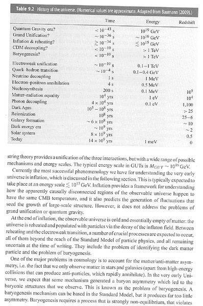

From the book "Relativistic Cosmology" by Ellis, Maartens, and MacCallum:
George Jones said:
Electroweak physics predicts the temperature/energy at which the electroweak phase transition occurs. For standard models of inflation and reheating, this temperature occurs after inflation and reheating.
Nice. Two questions: It states that photon decoupling occurred ~ 40,000 years, not ~ 400,000, and the dark ages started at 100,000. But the CMB seems to date from 400,000, or a bit less. What's up there?
Second, if electroweak decay happens long after inflation, does that mean that we have clear observational evidence (from the CMB, if nothing else) that there is not spontaneous symmetry breaking -- or at least that everything observable was part of a single domain?

Typo (I think).
The electroweak phase transition is distinct from the spontaneous symmetry breaking event which sets the masses of the W and Z bosons.
The electroweak phase transition occurs when weak force interactions are no longer rapid, and its temperature is a function of the masses of the W and Z bosons.
The time on that graph most likely associated with the spontaneous symmetry breaking event which set the masses of the W and Z bosons is the grand-unification time, which is stated with a question mark as this is still uncertain (and happens at higher temperatures than are produced during reheating).

I always thought these were the same. In the analogy you gave earlier in the thread, the rods settling down into a certain direction on the table is the symmetry breaking event; and the direction of the rods corresponds to the Weinberg angle, which sets the W and Z boson masses and separates out the weak and electromagnetic interactions, and is the phase transition.

Thanks, @kimbyd. My own question here was about the separation of electroweak into E&M and weak. That presumably occurs long after GU, right? But well before the end of inflation, according to the 1-degree-on-the-sky limit.
