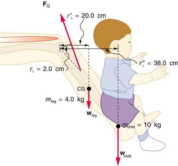

When a mother lifts he child with her foot (as shown in figure) what force should the upper muscle exert to lift her child at a constant speed?
W = F x D
f = mg
I think these might be the right equations to use, correct me if I'm wrong.
I'm not sure if I need to add up the forces and distances shown in the figure? If I did W would be:
W = (0.2m + 0.38m)(39N + 98N)
W = 0.58 x 137 = 79.46Nm
Do I need to convert kg into N?
f = mg
f = 137N x 9.80 m/s
f = 1342.6
Is this at all in the right tracks?
Work is not needed here. This is a levers problem. You need to convert the forces to torques and sum them.

I gave it a shot and got an answer that is 45Nm, can the force of the muscle be written in Nm?
No, the force has to be in N (Newtons).
I think your answer of 45 Nm is the correct torque that the muscle has to provide, but it is not the force. You have to calculate the force from that torque.

So I can do F = t/D ?
I tried to do 45Nm / 0.02m = 2250 N
Is there any more work than that needed?
I think that's right.
That looks like the right answer to me!
