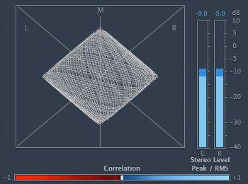

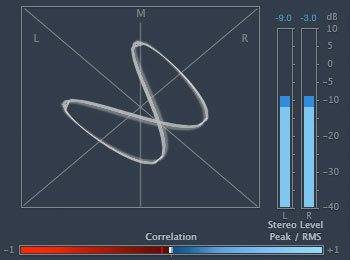

Now I did check these frequencies in a phase scope and these were my findings:
1) 440 Hz and 780 Hz
2) 380 Hz and 440 Hz
3) 440 Hz and 880 Hz
4) 440 Hz and 670 Hz
5) 230 Hz and 335 Hz
The only frequencies which looks harmonic to me are 440 Hz and 880 Hz. The rest both look and sound non-harmonic to my eyes and ears. Yet, my teacher claims 1 and 2 are harmonic.
