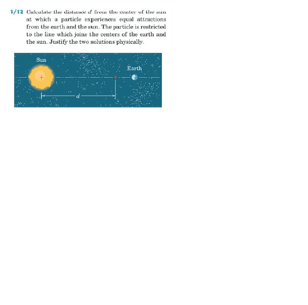

Mutual attraction force - did I do something wrong?
In summary, the problem involves finding the equilibrium point between a particle and the Earth and Sun, with the distance between the Earth and Sun being 149.6*10^9m. The two solutions are at 0, representing the center of the Earth, and 2.992*10^11m, representing a position to the right of the Earth where the Sun and Earth both pull the particle to the left with equal force. This can be justified by considering the mass of the sun being much greater than the Earth, causing the particle to be closer to the Earth in order for the mutual attraction forces to be equal.
pyroknife
613
I attached the problem.
F=G*m1*m2 / r^2
Fs=mutual attraction force between particle and sun
Fe=mutual attraction force between particle and earth
mass of sun(ms)=330,000*mass of earth(me)
mp(mass of particle)
x=distance between centers of Earth and sun=149.6*10^9m
Fs=G*mp*ms / d^2 = G*mp*me / (x-d)^2
I cancel out G and mp and cross multiply to get
ms*(x-d)^2 = me*d^2
330000*me*(x-d)^2=me*d^2
330000 (x^2-2dx+d^2) = d^2
330000(149.6*10^6)^2 - 2*(149.6*10^6)*d+329999*d^2=0
I then applied the quadratic formula and got d=0, 2.992*10^11 m. Do those look right? Also the last part wants me to "justify the 2 solutions physically." I'm having some trouble on how to do that. Can someone give me a hint?

Where would you expect to find the equilibrium point? About?

Something must be wrong here?
You say the centre of the Earth is 149.6 x 109m = 1.496 x 1011m
At the point where the attraction from the sun and Earth match, the body must be between the Earth and Sun.
Your answer of 2.992 x 1011m is twice as far from the sun, as the Earth is; not less distant from the sun ??
Yeah that's what I was asking about ... the other solution is 0 too - suggesting there is a second equilibrium point at the center of the Sun. That would be the case with no Earth. (Note: this is an example of justifying the solutions physically.)

You should draw a picture first. You would see that there are two position for the particle where the force from Earth is the same as that from the Sun - one position between the Sun and Earth, the other one outside. Try to show.

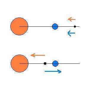

The origonal question/diagram certainly implied that the answer sought was between the Sun and Earth.
In the context of the original diagram that means the Sun pulling left, and the Earth pulling right with equal sized forces. One of your solutions is probably that.
It has previously mentioned that another possibility was a position to the right of the Earth [again referencing the original diagram] where the Sun and Earth both pull left - with a force of equal size.

I would expect one solution to be between the Sun and the Earth, much closer to Earth than it is to the Sun. The other solution should be beyond the Earths orbit.

Yes, the distance must be much smaller from the Earth to make the forces of equal magnitude, as its mass is very much smaller that the mass of Sun.
There is one place at distance d1<X from the Sun and distance X-d1 from the Earth where the attraction forces are equal, (and point in opposite directions) and there is a place at distance d2>X from the Sun and d2-X distance from the Earth where the attraction forces are equal and both point towards the Earth.
As it is difficult to handle big numbers, try to solve the problem pretending that G=1, M(Sun)=9 and m(Earth)=1 and x=4. Use both your way of solution, solving the quadratic, and mine one. Calculate the forces at both positions.
