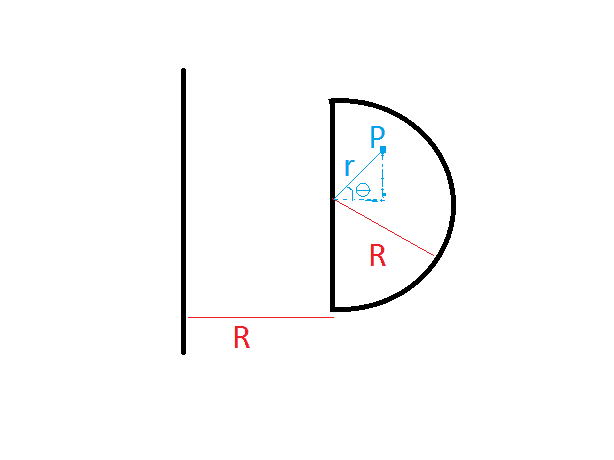

Calculate the mutual inductance between a very long, straight wire and a semicircular loop
B = µI/2πr
Φ = ∫B.dA
I think I have to assume a point like P in the semicircle. The point in terms of r and θ: P (r,θ).
So the magnetic field at that point:
B = µI/2π(R+rcosθ) .
So the magnetic flux:
Φ = ∫B.dA= µI/2π ∫∫ rdrdθ / R+rcosθ .
Is this the correct solution?

I think your expression for Φ is correct. (I added parentheses in the denominator.) But the integration looks hard to me. I would avoid using polar coordinates r and θ. Can you think of another way to set up the integration over the semicircular area that takes advantage of the fact that B is independent of the vertical position inside the area?

Vertical strips

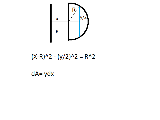

Yes, the strip's height 2y depends on x. Can you find the functional dependence of y on x?
Likes BvU

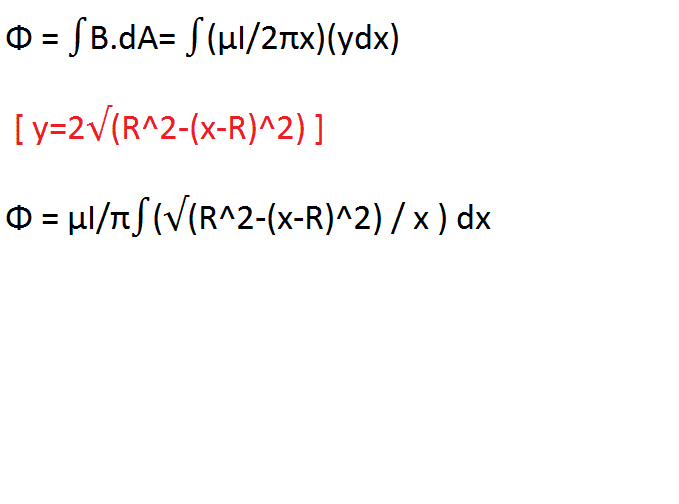

I turned your idea into the following shot:
But calculations with regard to this idea:
Yes, looks good so far. You had a sign error in your first equation of post #10, but post #11 looks OK.

The integral should be similar to the following integral:
Φ = µI/π ∫ (√R-x / √R+x) dx
Is there a way to achieve this integral?
Yes. Good. Your x here is the same as the x in my figure of post #9. Try letting x = Rcos(2θ) and recall some trig identities. Note that we're very lucky that the distance from the wire to the loop is the same as the radius of the loop! Otherwise, the integrand would not have simplified to your expression above.

The symbol x has a different meaning in the two integrals. In post #11, you were letting x represent the distance shown here:
But, in post #14, x represents the distance shown here:
Suppose we use a capital X for your distance in post 11 and a lower case x for the distance shown for post 14. Then your integral in post 11 would look the same except for using X instead of x. To get the integral for post 14, you need to change the variable of integration from X to x. What is the relation between X and x? Use this as a substitution to get from the integral in 11 to the integral in 14. Also, be sure to include the limits for the integrals.

How did you find that x is the same as x in post #9 ?
X=R+x , dX=dx
so:
Φ = µI/π ∫ (√R^2 - x^2 / R+x ) dx .
But it's still different from the integral we want. But this seems to be the utmost similarity to the integral we want.
When I first worked the problem, I chose x as shown in post #9. It seemed more natural to me to do it that way. This led directly to the integral of post 14. But your choice is not wrong, it's just not as convenient. If you set up the integral as you did, then you are naturally led to making a substitution that effectively takes you to a variable of integration that represents the distance x of post #14. Then you can proceed with a further substitution x = Rcos(2∅).
Likes peace
peace said:
X=R+x , dX=dx
so:
This can be simplified to what you want. Factor the expression in the square root.
Likes peace
Φ =µI/π ∫ √ (R-x)(R+x) / R+x ) dx
Φ =µI/π ∫ √ (R-x)√(R+x)/R+x) dx
so:
Φ =µI/π ∫ √ (R-x) / √(R+x) dx .
