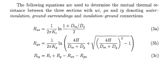

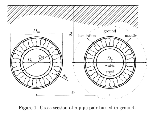

INTRO: In this reference, the mutual thermal resistances between layers as water-insulation, ground-surrounding, and insulation-ground are defined for a buried pre-insulated pipe, figure and formulations given below:
FIGURE:
244535
FORMULATIONS:
244536
QUESTION: I want to improve the model given in this reference by studying the layers as water, steel, insulation, and ground so I need to obtain the mutual thermal resistances between water-steel, steel-insulation, insulation-ground, and ground-surrounding. I couldn't find a reference describing how to find the thermal resistances between layers of a cylinder such as between water and steel and others. Can any of you help me either by giving formulations or by guiding me to a reference?
