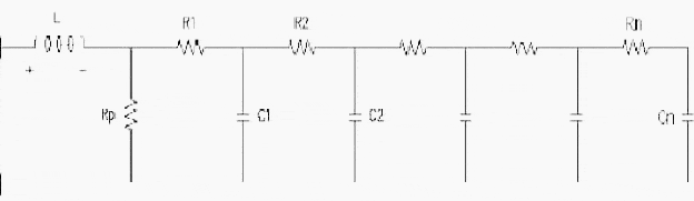

Supercapacitors have a number of http://eprints.soton.ac.uk/272829/1/Supercap%20Journal.pdf . Not only do they have an ESR, but they have a series inductance and parallel resistance. I suspect your problem is with the inductance.
Supercapacitors store their energy in an electrolyte. It can take hours to charge or discharge fully.
The name "supercapacitor" isn't that great. They are more like lame batteries than capacitors. They have niche uses where they are clearly the best part for the job, but outside those areas, they tend to be problematic.

If you short a supercapacitor, then open it, you will see the voltage climb back up. The energy is there, but it acts like lots of small capacitors in parallel with resistors in in between. SO the last capacitors have extremely long time constants (high esr).
