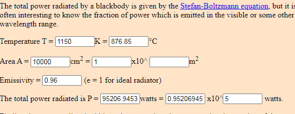

4% absorption ( at the 60TW power level ) gives 96000 W/square meter.
( 4% of 2,400,000 W/m2
Accordingly, your sail should heat up only to around 1150 K.
from Hyperphysics Black Body radiation.
Poof!
berkeman said:
Poof!
I edited the post - had it the wrong temperature.
Does that seem reasonable for thee things?
A thin sail without significant heat resistance would have the same temperature (and therefore the same heat emission) at both sides. That results in a temperature of 960 K.
