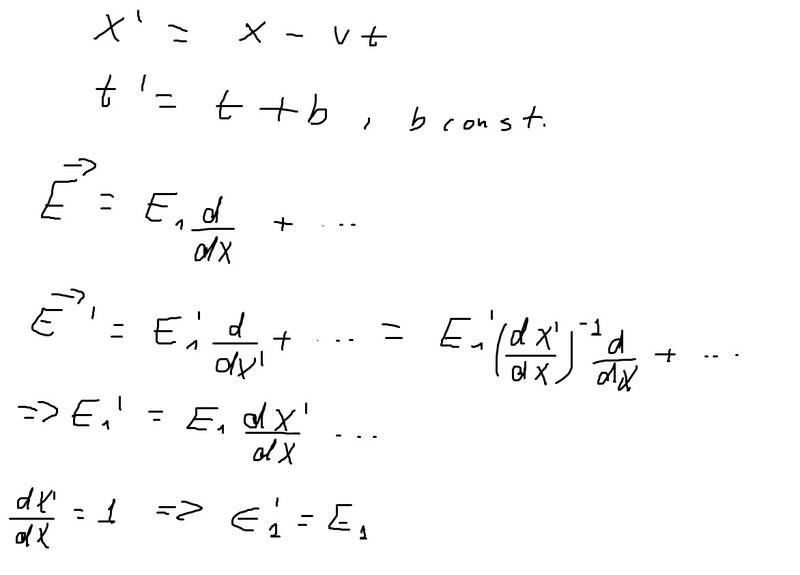

It's astonishing I'm obtaining that some of Maxwell's equations are invariant under Galilean transformations. I have done the calculations all the way here.
Please show your work.

davidge said:
Am I doing something wrong?
Yes, this approach is not showing what you want to show. What we are trying to show is how the whole equation transforms. So we want to show that when you transform ##F=q(E+v\times B)## you get ##F'=q'(E'+v'\times B')##. Under the Galilean transform ##v'=v+u## and ##F'=F## from the definition of the Galilean transform and the Galilean invariance of Newton's 2nd law. I don't remember the reasoning why ## q=q'## but I am sure you can dig that up somewhere.
So consider ##u=-v##, then ##q'E'=F'=F=q(E+v\times B) \ne q E##. Similarly for B.
davidge said:
At a later time I found a page on web where the guy derives it in a way you and others here will probably accept as valid.
No, actually, I don't. Perhaps it will help to write down the correct expressions for transforming derivatives with respect to the coordinates. For simplicity, I'll consider the case of one spatial dimension, so the Galilean transformation is ##x' = x - vt##, ##t' = t##, and the inverse transformation is ##x = x' + v t'##, ##t = t'##. Then we have
\frac{\partial}{\partial x'} = \frac{\partial x}{\partial x'} \frac{\partial}{\partial x} + \frac{\partial t}{\partial x'} \frac{\partial}{\partial t}
\frac{\partial}{\partial t'} = \frac{\partial x}{\partial t'} \frac{\partial}{\partial x} + \frac{\partial t}{\partial t'} \frac{\partial}{\partial t}
From the inverse transform equations, we obtain ##\partial x / \partial x' = \partial t / \partial t' = 1##, ##\partial x / \partial t' = v##, and ##\partial t / \partial x' = 0##. This gives
\frac{\partial}{\partial x'} = \frac{\partial}{\partial x}
\frac{\partial}{\partial t'} = v \frac{\partial}{\partial x} + \frac{\partial}{\partial t}
So, contrary to the claim made in the link you gave, we do not have ##\partial / \partial t = \partial / \partial t'##.
Furthermore, when transforming the fields ##\vec{E}## and ##\vec{B}##, we have to remember that these are functions of the coordinates, and they will not, in general, be the same functions in both frames. For example, suppose we have an electric field that, in the unprimed frame, is that of a point charge at rest, i.e., ##\vec{E} = Q / r^2## and ##\vec{B} = 0##. In the primed frame, this will be the field of a moving charge, so at a given spatial point, the distance from the charge will vary with time (so ##\vec{E}'## will now be a function of ##t'## as well as ##r'##), and there will be a nonzero magnetic field ##\vec{B}'##. So you can't just assume that ##\vec{E}' = \vec{E}## and ##\vec{B}' = \vec{B}##.
