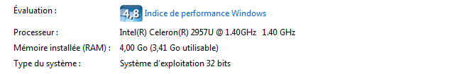

hi
what computer system are you running it on ?
what are its spec's ?
Likes ernd59
davenn said:
hi
Windows 7
can you provide the model for the diodes?
some things you can do to make it faster...
change the integration method to trapezoidal.
decrease the tolerance.
put large (10 meg) resistors in parallel with the inductors.
sim it for less time.
record less of the simulation.
You are running a simulation at a very small time-step (switching is occurring on a microsecond scale) for 30 seconds. is that necessary?
