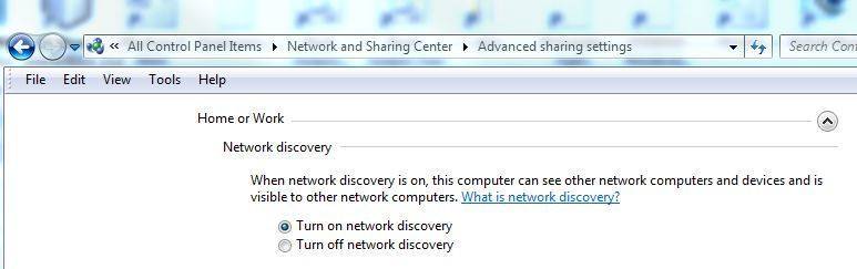

Take a look at your setting in this section of your Control Panel. Maybe it got set to turn off network discovery.
There are three sections there so it's possible that your current network connection is set to be something other than "Home or Work".

Thanks guys. I tried the device updates and verified the network discovery thing... still no luck. If I go into device manager and look for Bluetooth, it shows a subcategory, " Intel (R) Wireless Bluetooth(R)" . If I right click and hit update drivers, it tells me they are up to date.
