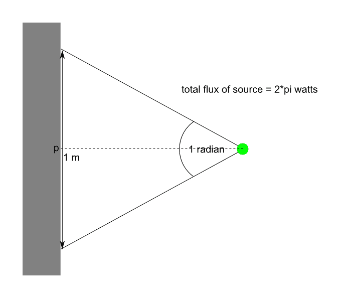

Hi all, been a while since I've posted here, but figured this would be a great place to ask this question.
I've gone over the first chapter of McCluney's Introduction to Radiometry a number of times, and more recently have discovered this great resource, but I am still confused about something.
For the purposes of this discussion, I'm reducing the number of spatial dimensions by one. So instead of solid angle (in steradians), I'll be using angle (in radians), and instead of area (in m2), I'll be using length (in m). This is done with the full understanding that in reality, light propagates in all three spatial dimensions and intersects surfaces and not lines. Nevertheless, I believe it's useful to simplify things here.
Take a look at this figure:
On the left is a surface receiving light from a point source on the right.
The total flux of the source is 2 pi watts, and we will assume that the angular distribution of flux is uniform, which means that the radiant intensity, as measured as exitant from the point source is uniform across all directions.
Given the above, we can now say that the amount of flux contained within the depicted angle is one watt (2*pi watts divided by 2*pi radians). This means that the radiant intensity exitant from the point source is exactly one watt/radian, and this radiant intensity is the same in all directions.
We can also say that the amount of flux incident upon the depicted length of the surface on the left is exactly one watt.
First question: Have I got this right so far?
yes
[itex]\frac{2\pi \text{ W}}{2 \pi \text{ radians}}\times \text{ 1 radian} = 1 \text{ W}[/itex]
But yes 1 W/ radian is the radiant intensity (usually W/radian^2 or W/sr )
spacediver said:
I understand that radiometric quantities are defined with respect to infinitesimals, and the partial, or elemental length of the surface on the left does not scale linearly with the partial angle subtended, so we can't say that the irradiance upon the surface at point P is one watt per metre. For instance, if we reduced our angle to half a radian, the length "covered" by this angle would be smaller than half a meter. Thus, as the angle gets smaller, the covered length becomes smaller at a greater rate. Thus, the flux density upon the elemental length becomes greater and greater as the angle approaches 0. Accordingly, the irradiance at point P is quite a bit greater than 1 watt/m. I lack the calculus know how to be able to figure out the derivative, but I'm guessing it has something to do with the derivative of tan theta, where theta is the angle in question.
You are right that the irradiance at different points along the surface will be different. This is because the irradiance from a point source follows an inverse square law, and different points along the surface are at different distances from the source. However, for the total surface the average value of 1 W/m (or W/m^2 in 3 dimensions) is true. If your surface were a sphere centered on the source, the value of irradiance would indeed be the same at each point as the average value.

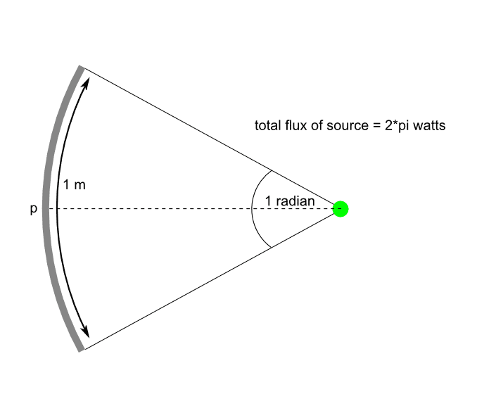

Here's a revamped figure, so now we can safely say that the irradiance incident at point P is 1 Watt/m.

spacediver said:
In my reduced dimensionality scenario, we know that the incident irradiance at point P, due to the point light source, is 1 Watt/m. We also know that the radiant intensity exitant from the point light source is 1 Watt/radian. So how do we calculate the radiance incident upon point P?
Apparently i wasn't thinking straight when I posted last. The average value of irradiance, is the power emitted through the angle, 1W, divided by the length (usually area) it is incident on. So if the rectangular object has a length L within the angle, then the average irradiance will be 1/L W/m, not 1 W/m.
For the semicircle, since all points are equidistant from the source, we know the value at any point must be the same as all the others. that's why the average value of irradiance is the value at each point.
