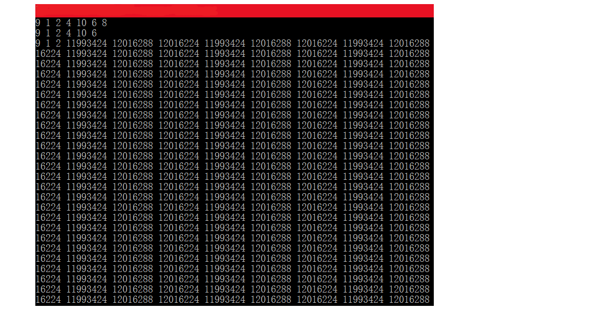

Yea! I was able to code my own first SINGLE LINKED LIST! but having a little issues with my deleting middle. As you can see if you take my code run it.
HTML:

My output:View attachment 6429
It will give me this:

1 2 10 4 6 8
Hi there,
First of all, congratulations on coding your first single linked list! That is a great accomplishment.
I can see that you are having some issues with your deleteMiddle function. From looking at your code, it seems like you are on the right track. However, there are a few things that I noticed that might be causing the issue.
1. In the deleteMiddle function, you are deleting the node that is in the middle, but you are not updating the previous node's next pointer. This means that the previous node will still be pointing to the node that was deleted, causing a potential memory leak. To fix this, you need to update the previous node's next pointer to point to the node after the one you are deleting.
2. In your main function, when you are creating the linked list, you are not setting the next pointer for the last node (node with value 9). This means that the next pointer for this node will be NULL, and when you try to delete the last node, it will cause an error. To fix this, make sure you set the next pointer for the last node to point to NULL.
3. Another issue I noticed is that in your deleteMiddle function, you are deleting the node that is in the middle, but you are not updating the counter pointer. This means that the counter pointer will still be pointing to the old middle node, which is now deleted. This can cause issues if you try to use the counter pointer later on. To fix this, make sure you update the counter pointer to point to the correct node after the middle node is deleted.
I hope this helps. Keep up the good work!
