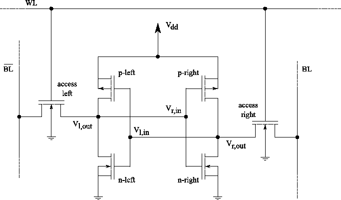

Recently, I have been researching RAM, including formats such as DRAM and SRAM.

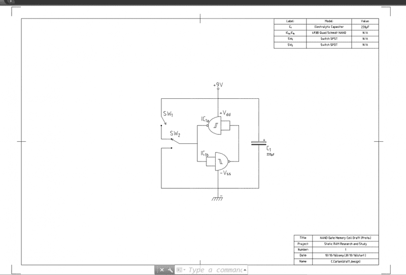

While I was running simulations on SRAM one week, I realized I could make a 1 bit Static Memory Cell using a simple Schmidt NAND IC.
I ran a draft for it displaying two feed backing NAND gates as inverters, and just one bitline connecting a SPDT to 4.5V and 0V.
I did this as just as an experiment to see if two NAND gates can be used to make a memory cell.

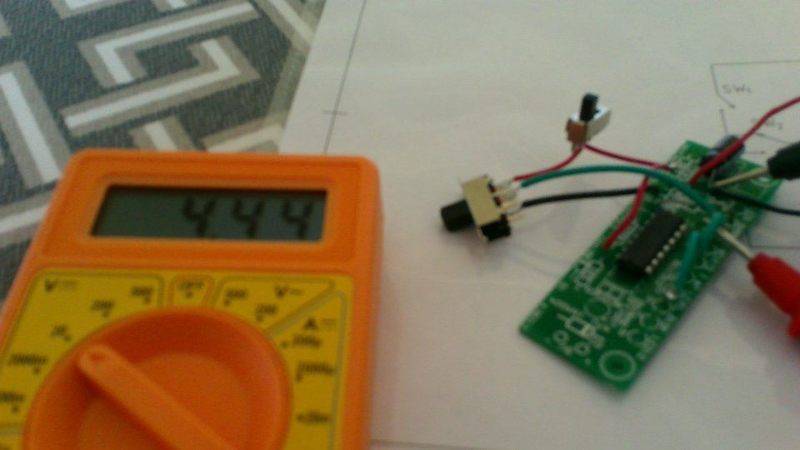

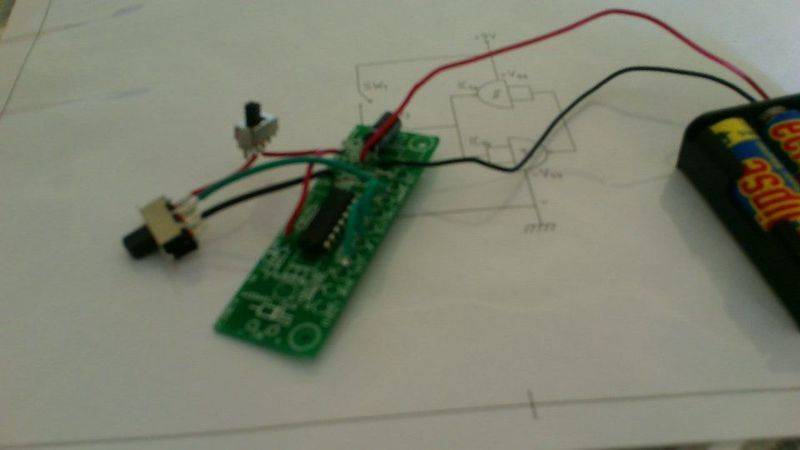

The supply voltage and Vdd is 4.5, (three AA batteries). The IC is 493B Quad Schmidt NAND. The capacitor is used as a safety charge for the CMOS circuitry. the two switches are basic SPDT ones I found lying around. The PCB is a spare Jaycar project I had and is irrelevant to the design.
When SW1 is on and SW2 is connected to 4.5V, you add 1 bit (4.5V) to the the memory cell node. When you turn SW1 off, the NAND node hold 1 bit. The same can be said vice versa when storing 0 bit when SW2 is connected to ground.
In fig.5, the multi-meter measures 4.44V (≈4.5, accepted tolerance of accuracy) across the node between IC1a output and SW2 to ground, when there is 1 bit stored; similar testing has shown 0V when 0bit is stored.

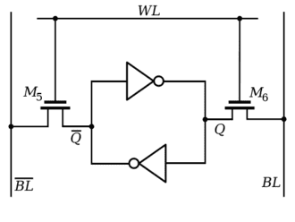

The figures attached show several examples of typical SRAM, (fig.1, fig.2); another figure shows a draft design on AutoCAD, (fig.3); other figures show photos of the actual design.

It's not good practice to short circuit the output of a logic gate to ground or VCC. Sure it may work if you use switches but it might not work if you use a logic gate instead of switches.
Take a look at an SR latch.
Thanks for thy feedback,
You are correct; it is not a good practice to connect the voltage supply to any other nodes. Since it can short the circuit, and damage some of the components.
However, this was an experiment to see Schmidt NAND gates can be used for a SRAM latch or memory cell. Also, the application of this will be an array of these, and the voltage supply will be separated with a suitable set of buffers.
The reason I do not want to use SR latch or a flip flop bistable latch is I want to research some of the conventional memory cell types of RAM.

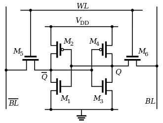

I am hoping to make a small model of an array of SRAM cells; however, I want to know should I use the typical inverters or FETs as the configuration of a SRAM cell. For example, in my case, FETs on a PCB will take up room.

One question I have might seem simple, but want to make sure, there is no need to bolt the tab/body/substrate to ground for the access MOSFETs connecting the wordline and the bitline? I thought there wasn't any need to until I stubble across this diagram.
In the attachment, notice the body is connected to ground?
Does this mean the hole needs to be bolted to a ground terminal?
Thanks in advance,
Check the data for the FET you plan to use.
Frequently the heat sink tab is connected to either the drain or source inside the device. This can sometimes cause problems if multiple FETs are bolted to the same heat sink. The heat sink can end up shorting one part of the circuit to another. Means you sometimes need insulating mica washers between the tab and heat sink .
However you don't really need a power device for this. Perhaps look at a lower power "logic level" FET in a smaller package?
