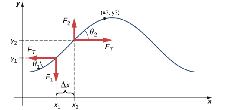

My textbook is deriving wave speed on a string under tension

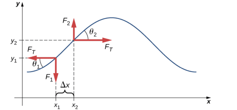

My textbook is deriving wave speed on a string under tension with confusing thetas. It assumes ##\tan \theta_1 = \frac{-F_1}{F_T}## and ##\tan \theta_2 = \frac{F_2}{F_T}## which confuses me. I know for sure theta is the angle due to the position of y and x, ##\tan \theta = \frac{y}{x}##, but I am confused how you can assume that theta is the angle between the forces. Attached is an image of a graph of the y position vs x position of a wave.

Consider point 2. Draw in the force ##F## exerted on the small segment of string. What are the x and y components of that force in terms of ##F## and ##\theta_2##?
That's not answering my question of how come ##\theta_2## and ##\theta_1## are the angles between the forces. ##\theta_2## could be greater or smaller. ##\theta_2## is the angle due to the y and x quantities but not necessarily the angle for the Fx and Fy quantities.
OK, let's try a different tack.
Why do you think ##\tan \theta = \frac yx##? I don't see where you're getting that idea from the diagram you provided.
Also, what you do mean by ##\theta## being the angle between the forces? The angle between the components shown is 90 degrees.

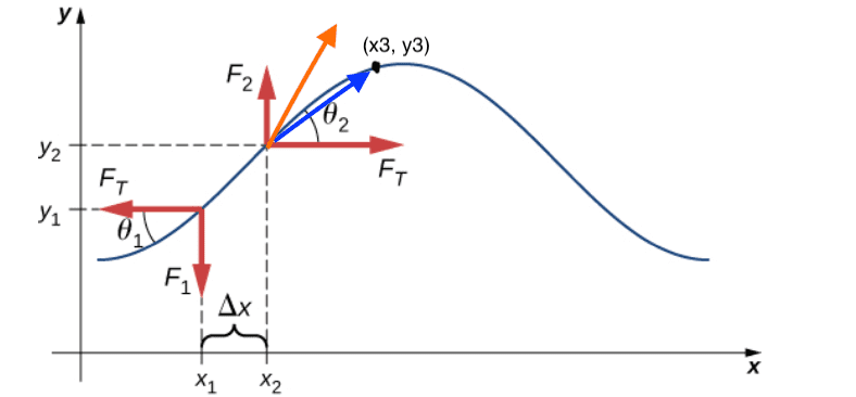

In the image attached, I added a point (x3, y3). ##\tan(\theta_2) = \frac{y3 - y2}{x3 - x2}## which has nothing to do with the forces. The forces may have a different ##\theta## where ##\tan(\theta) = \frac{Fy}{Fx}##
Which way do you think the force the righthand portion of the string exerts on the segment points? (That's why I asked you to draw in that force.) Do you think the situation I drew in the picture is possible?

No, I know that. You're not understanding my question. I attached another image. The blue arrow is one possibility of a resultant force vector in which ##\tan(\theta_2) = \frac{Fy}{Fx}##. The orange arrow is another possibility of a resultant force vectors in which ##\tan(\theta_3) = \frac{Fy}{Fx}##. ##\theta_2 != \theta_3##
You're right. I don't understand what you're asking. What do you mean by ##F_x## and ##F_y##? It's apparently not what I think you mean.
##F_x = F_T## and ##F_y = F_2##

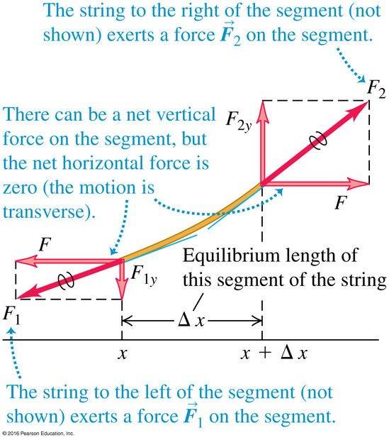

Does this figure help?

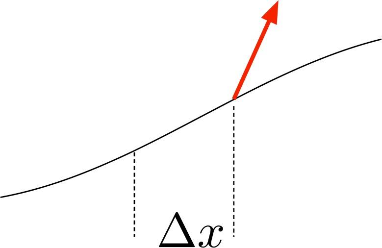

The force on each point on the string can only come from adjacent parts of the string. Therefore, the force is always parallel to the string at each point. There is only one possibility for the angle, which is the angle the string itself makes.

Imagine the string as a large number of finite segments. The force on each segment is applied by the two adjacent segments, one on either side.
The continuous solution comes from taking the limit as the segment size tends to zero.

Quite arbitrarily (but obviously the best choice) the tension force has been resolved into a lateral and longitudinal force. This sort of approach is the way we solve hundreds of problems but is probably only valid for small displacements and the diagram exaggerates the scale so that the vectors can be drawn on a diagram.

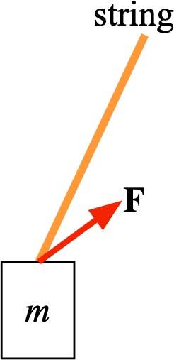

As I was composing another reply, I think I figured out what your question was. Say you have a mass suspended by a string and you pull on the string to accelerate the mass to the right. I think you're envisioning a force on the mass like this:
where the force exerted by the string doesn't necessarily point in the same direction as the string.
In the typical model of a string, this won't happen. If the string were able to pull on the mass like that, Newton's third law says the mass would pull on the string with an equal and opposite force. The reaction force would causing the tilt of the string to increase, i.e. the string will rotate, until the force is collinear with the string. The assumption is that the string will respond so quickly that the force always along the direction of the string.

No, a segment is part of the string. The diagram in your original post shows the segment between ##x_1## and ##x_2##.
Adjacent means adjoining or next to.
The string segments exert forces on each other, like links in a chain.
Likes Ibix

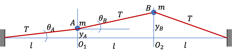

Consider a series of beads of mass ##m## connected by massless rigid rods. With ##N=2## beads, it would look like
You can consider a string as the limit of this model when ##N\rightarrow\infty## and ##l\rightarrow0##.
