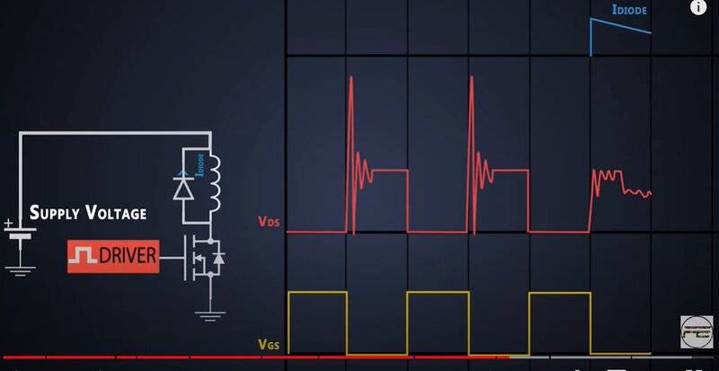

AH! I've seen diagrams with a diode that does that exact job. That would be much easier than sticking a capacitor in there. My problem now: I'm not educated enough in diodes to know what size, what polirity, and where in the circuit it should go. If you could "educate" me in that regard, I'd be most grateful!
Bruce Ratcliffe
Dear Baluncore, I went to my goto source (Youtube) and found a video that addresses my concern. The video what quite educational, but I'm still unsure exactly WHERE to solder in the diode. My guess would be to connect it across the wires going to the motor, with the negative pole of the diode connected to the positive lead going to the motor. I have a bunch of big, beefy-looking diodes (10A10) and some more modest (MUR4109427) diodes in my shop. Of course, considering what a cheap fix this would be (compared to$70 per switch--when I can even find some for sale), I'd be glad to purchase whatever you recommend. If so, that would be an easy "operation"--no need to pop open the switch, which is quite a trick. Want to correcet my exam answer, Teach'?

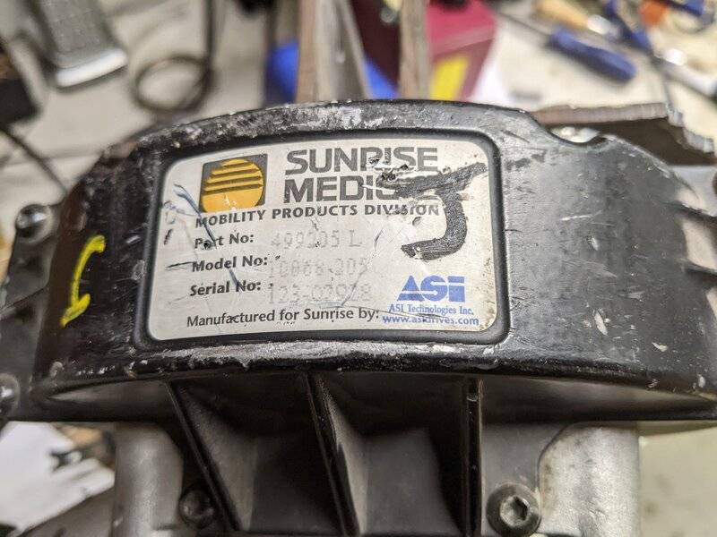

AIE! I've been having my kids build these "eCars" for 20 years, but I never looked closely at tahe motors. I can tell you there are out of wheelchairs. There are large curved permanent magents on the insides of the motor housing and there are brushes on opposides sides of the motor housing with spring-loaded carbon brushes contacting the motor shaft on the inside. If this is not enough information, I'll dissect a motor to find out more detail.
Bruce
Do you use forward and reverse, or always the same polarity and rotation direction?
The diodes primarily need to be fast recovery; rated at two or more times the battery voltage; for the average motor current, the sort of thing you can take out of an old computer power supply. To catch spikes, the diodes do not need a heat sink as used in the computer PS.
Take a look at the specification plate on the motor. Maybe there is a part number and manufacturer's name.

Here is the spec plate on the momtor. NOw that you mention it, it DOES have forward and reverwse modes. This would seem t make problems with a diode--wouldn't 1 of the 2 diodes always be condecting current AROUND the motor?
