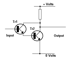

Do you have a circuit that looks something like this? And resistor replaced with a diode..

That could be a collector-emitter leakage current of the first transistor Tr1 driving the base of the second transistor Tr2.
