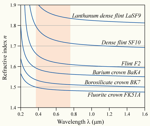

Yes. You don't even need to go that extreme; violet and red wavelengths have different speeds in glass.
Here is a graph of n vs. λ for several different types of glass: visible wavelengths are shown by the pink band:
