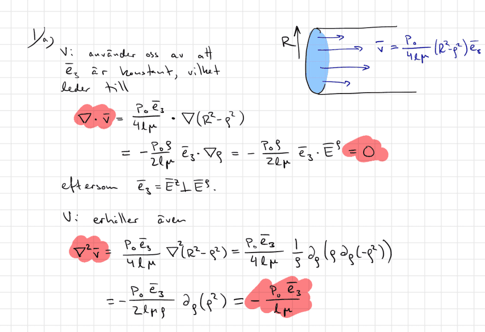

A liquid flows in a cylindrical tube with the z-axis as the axis of symmetry and radius R. The flow rate of the liquid is given by $$ \vec v = \frac {p_0} {4lμ} (R^2-ρ^2)$$
where ##\frac {p_0} {l}## is the pressure drop in the pipe per unit length, ##μ## is the viscosity of the liquid and ##ρ## is the radial cylinder coordinate. Calculate ##∇\cdot\vec v## and ##∇^2\cdot\vec v##
Here is how my teacher solved this:
I understand what the nabla operator does, ##∇\cdot\vec v## means that I am supposed to calculate ##\sum_{n=1}^3\frac {d\vec v} {dx_n}## where ##x_n## are cylindrical coordinates and ##\vec e_3 = \vec e_z##. I understand why ##∇\cdot\vec v = 0##, I would get the same answer as my teacher if I used ##\sum_{n=1}^3\frac {d\vec v} {dx_n}## to calculate it. However when I calculate ##∇^2\cdot\vec v## I don't get the same answer. I would get ##∇^2\cdot\vec v = (∇\cdot (∇v_1),∇\cdot (∇v_2),∇\cdot (∇v_3)) = \frac {p_0} {4lμ}\cdot (0,0, ∇\cdot (∇(R^2-ρ^2))) =\frac {p_0} {4lμ}\cdot (0,0, \frac {\partial^2 (R^2-ρ^2)} {\partial ρ^2})##. Which is not equal to what my teacher got. Did I miss something? Also could someone explain the steps he took to arrive at his answer?
Thanks in advance!

Not exactly. If you're using cartesian coordinates, then
$$\nabla \cdot \vec v = \frac{\partial v_x}{\partial x} + \frac{\partial v_y}{\partial y} +\frac{\partial v_z}{\partial z}.$$ If you're using cylindrical coordinates, however, the divergence takes on a more complicated form. See, for example, https://en.wikipedia.org/wiki/Del_in_cylindrical_and_spherical_coordinates.
I think if you visit that Wikipedia page and see what the Laplacian is in cylindrical coordinates, it'll answer your question. Your notation is a bit off too. Note that your professor wrote ##\nabla^2 \vec v##, not ##\nabla^2 \cdot \vec v##.
This is another consquence of [itex]\mathbf{e}_\rho[/itex] and [itex]\mathbf{e}_\phi[/itex] not being constant.
In this case it's not too difficult to calculate [itex]\nabla \cdot \mathbf{v}[/itex] and [itex]\nabla^2 \mathbf{v}[/itex] in cartesian coordinates using [tex]
\nabla (\rho^2) = 2x\mathbf{e}_x + 2y\mathbf{e}_y[/tex] and [tex]
\nabla \cdot (f\mathbf{g}) = f\nabla \cdot \mathbf{g} + \mathbf{g} \cdot \nabla f.
[/tex]
