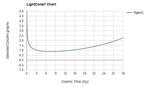

This bit is incorrect. For most of the history of the universe, comoving observers have been receding from each other at recessional velocities higher than ##H_0d##. It's only since approx. 5Gly ago that the velocities are increasing. See the graph below:
As you can see, the initial impulse was very high. During the period of high density, recessional velocities were retarded at a very high rate. Around the 8Gly point, due to continuous dilution of matter and radiation dark energy density started dominating, and recessional velocities begun increasing.
Just to ensure that Jeff understands the meaning of the graph, Vgen stands for the recession rate of a generic galaxy that presently has a recession rate of c, i.e. some galaxy that is somewhere on the Hubble sphere now, at a comoving distance of 14.4 billion light years from us. Due to the accelerated expansion, that galaxy is presently moving through our Hubble sphere from the 'inside'. It came into our 'then' Hubble sphere at t ~ 3.5 billion years.
It's similar to calculating a time t=d/v for a car moving at a varying speed v(t). The proper way is to rephrase the expression into an integral.
