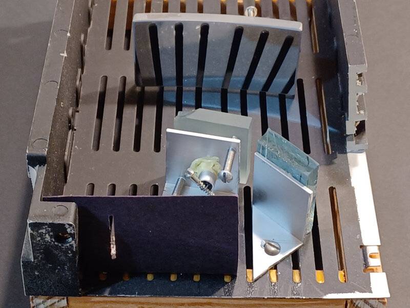

remains of previous experiment

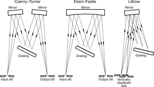

I'm more familiar with it being called Ebert-Fastie, or simply Ebert.
Below are three configurations I am most familiar with.
