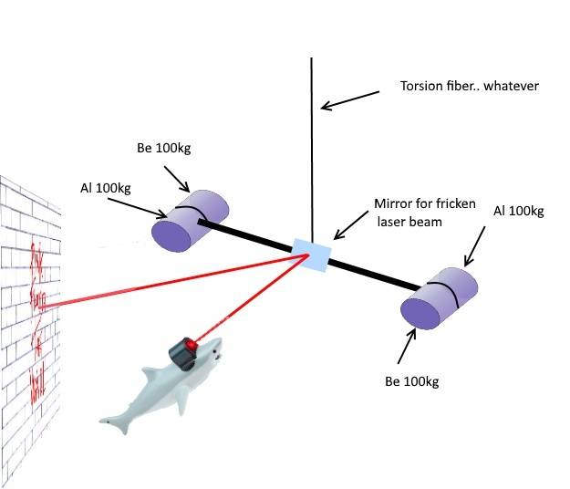

The following diagram shows a torsion balance experiment similar to Cavendish experiments, that uses a laser reflected off a mirror attached to the torsion balance so that small deflections of the torsion balance can be detected on a "far away" wall.
The cylinders are 100kg ~100% Al on one end, and 100kg ~100% Be on the other end because those substances have decent particle number difference for the same mass (there are more particles per mass in the Al than in the Be, so the deflection would be in the direction of the Al if gravitational acceleration is correlated with the number of particles in the sample, instead of the mass of the sample).
There would be no deflection if gravitational acceleration was correlated with mass, instead of number of particles.
To reiterate:
I'd like to know the name of this experiment, and the name of the theory that gravitational acceleration is more closely correlated with mass than the number of particles in a volume of spacetime. I'm hitting a Google block...

Um, the experiment you're describing in those posts is a Cavendish experiment with different materials for the different masses.
Exactly. The number of particles per kilogram is about 2% different for lead as paraffin.

Not exactly. The Al/Be masses are one object, instead of displaced like in the Cavendish experiment.
Ah, I see. I don't think there is a simple name for this experimental configuration. I don't know that an experiment with this configuration has actually been done.
I also agree with other posters who have said that, if this experiment were to show a deflection, one would expect Eotvos experiments to show a deflection too. Here's why: in the Newtonian approximation, which is what you are implicitly assuming here, you can't say that one mass, such as the Earth or the Sun in Eotvos-type experiments, is a "source", so you are testing how its field depends on its mass and other properties, and the other mass, such as the test masses in Eotvos-type experiments, is not. Eotvos experiments compare the mutual attraction between the Earth or Sun and bodies of different composition. If test masses of different composition acted differently as sources, then they would produce a slightly different mutual attraction with the Earth or the Sun, because they are just as much "sources" as the Earth or the Sun is. So the fact that Eotvos experiments show no difference in behavior with test objects of the same mass but different composition is strong evidence that the behavior of an object as a "source" depends only on its mass.

Matt, I know you keep saying "not Cavendish or Eötvös", but unfortunately, those are exactly the kinds of experiments that show this. Newtonian gravity does not distinguish "source" and "target" masses. It's mutual attraction. Indeed, it's just better to say "larger mass" and "smaller mass" rather than "source" and "target".
Here is the argument:
  1. A gravitational attraction due to particle number would manifest itself as a composition-dependent gravitational force.
  2. Strict limits on the magnitude of this have been obtained by Eötvös-type experiments.
  3. The gravitational attraction between A and B is mutual: the force on A due to B is the same as the force on B due to A.
Do you disagree with any or all of these? If so, which one(s)?
If not, how can you escape the conclusion that an experiment that shows no variation when varying the composition of the smaller mass also implies that there is no variation when varying the composition of the larger mass?

Matt Benesi said:
Eötvös-type experiments do not detect or set limits on composition dependent gravitational acceleration. They set limits on composition dependent gravitational mass, which may or may not be directly coupled with gravitational acceleration.
What they actually set limits on is gravitational force. If you want to argue that acceleration due to a particular number of Newtons depends on whether the force is gravitational or not, we need to take yet another step back and discuss the validity of Newton's Laws.
Matt Benesi said:
Maybe. Depends on whether there is composition dependent gravitational acceleration or not.
Again, we're getting to the question of whether Newton's Laws are valid or not.
Likes Matt Benesi
Doesn't this drop back to Avogadro's Number and moles? A mol of lead is 202g and a mol of hydrogen would be 1g and yet have the exact same number of atoms so if they were co-orbiting in a perfect, friction-free vacuum the hydrogen is going to appear to be orbiting the lead. Also, since Hydrogen is a gas (typically) it takes up move volume, but the center of gravity is still the same, and you can match one per one, atom to atom, and while they will show a range of differences for each pair of atoms, they all average out when corrected for the radius from the center of gravity for each particle to every other particle, and they all add up the same (or at least they Should)
Yes, they do. Your failure to understand this does not make it false. It's pointless to continue going around in circles about it. Thread closed.
