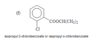

Naming the following benzene structure
In summary, the conversation discusses the naming of a chemical structure, specifically isopropyl-2-chlorobenzoate and 2-chloroisopropylbenzoate. There is confusion over the placement of the chlorine substituent and whether it should be specified as attached to the isopropyl group or the benzene ring. The conclusion is that 2-chloroisopropylbenzoate may not be specific enough and isopropyl-2-chlorobenzoate clarifies that the chlorine is attached to the isopropyl group.
chirumu
i understand that benzoate is derived from carboxylic acid (COOH) to which isopropyl has replaced the H, forming a benzoate substituent to which we derive the parent name of the structure. I understand that Chloro is the name for the Cl substituent and that it is joined to C2. What i don't understand is why the structure is called:
as opposed to
does it possibly have something to do with the fact that 2-chloroisopropylbenzoate does not specify whether the Cl substituent is joined to C2 on isopropyl or benzene? Or does the isopropyl group take priority over the Cl group?
isopropyl-2-chlorobenzoate isn't alphabetised and that's what confuses me the most here.
Not quite sure and in need of a little help. Thankyou.
That would be my understanding - chloroisopropyl suggests to me chlorine attached to isopropyl, not to the benzene ring.
