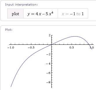

Now we know the function is increasing everywhere to the left of this critical and decreasing everywhere to the right of it. We also know the function is concave down everywhere except at the origin. Hence, putting all of this together, we obtain a graph closely resembling the following function plot:
To the OP,
I am sorry, but Yahoo! Answers will not allow me to answer your question on how to access the graph in the comment field there for some reason. As a guest you should still be able to click on the attachment link to see the graph.
If that doesn't work for you try this link:
y=4x-5x^4 for x=-1 to 1 - Wolfram|Alpha
