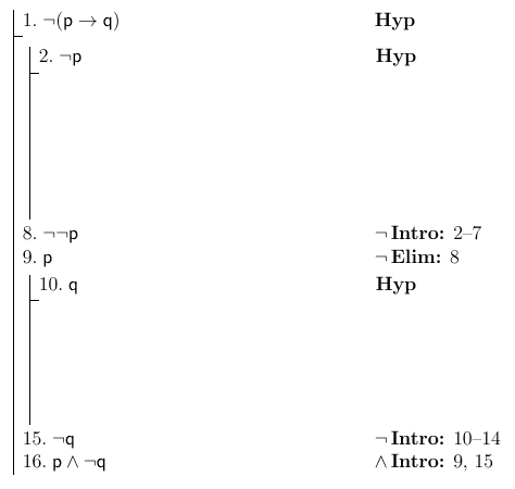

Right, exactly. I would think about using $\lnot$ elimination. It's a powerful method, because you can construct sub-proofs by assuming anything you want. Don't forget contradiction elimination, where you can conclude anything you want from a contradiction. That's an important proof technique in subproofs. What outline do you have?
Here's what I mean by outline, and this is what I would recommend for you to do. Basically, you're going to use $\land$ intro as the main organizing principle.

Is step 2 hypothesis for contradiction??

Yep, that's right!

Then on the 6th step we should have ~~P and not on the 8th step

Well, that just depends on how many steps it takes you to get a contradiction. No doubt you are more efficient at it than I am.
