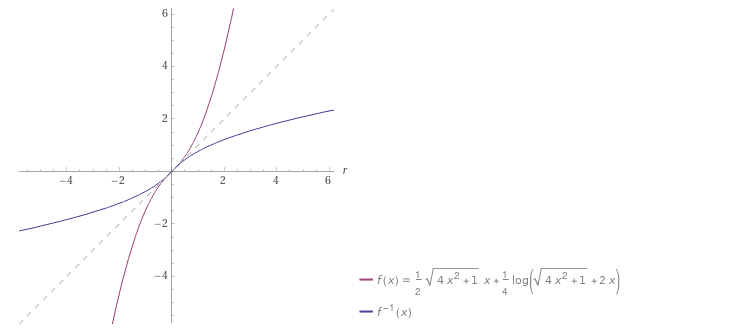

The idea is to write x,y,x as a function of s, i.e., x(s),y(s),z(s). If I can calculate r(s), then I can write x(r(s)),y(r(s)),z(r(s)), but I can't calculate r(s) from that equation
I am afraid it is a tough thing to get the formula of r(s) from s(r) formula.
