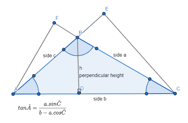

The reason I'm asking is because I'm writing an article on the "Tan Rule" (to add to the sine/cosine/area rules 'toolbox'!). Two applications thereof are "classical" Compton Scattering and determination of launch angle for a projectile (based on the angular momentum equation). I was struck by the similarity between these two situations which employ almost identical vector diagrams for solution. I hoped there might be a Compton scattering "analogue" of the angular momentum equation.
Will be posting shortly for review.
