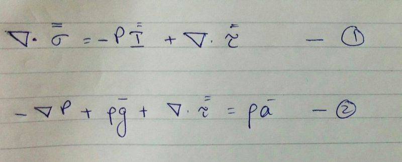

I was watching a lecture in which the professor derived the Navier Stokes Equations for const density and viscosity. He however skipped a step and directly went from one equation to another without giving any explanation. I have attached an image file in which the 2nd equation is derived from the first equation. Can anyone please explain how this came to be?
I apologize in advance for uploading a handwritten equation.
oh 'I' in the image below is the identity matrix

I think in equation one, sigma represents a molecular stress which is equivalent to a pressure (stress) plus a viscous stress. The pressure stress always exists in the fluid (I believe due to random motion of molecules, but can't remember precisely) but the viscous stress arises from velocity gradients. If you want more information on this, consult a transport textbook like Bird, Stewart and Lightfoot Ch 1.
The identity matrix (or sometimes the kronecker delta function is used) is required since pressure is defined as a perpendicular (normal to a surface) "stress" only. Also note that the viscous stress acts in an arbitrary direction, and it can then be decomposed into perpendicular and parallel (against a surface) components.
Then in equation two, we have a balance of forces, which the Navier-Stokes equation is, and he has that molecular stress term + gravity forces = mass*acceleration
The mass multiplied by acceleration is written in terms of density and often referred to as an "inertial" term. He then substitutes the molecular stresses into equation 2 from equation 1.
Also note he has neglected body forces in equation 2, and, as I understand it, the "constant" density strictly means that the density does not change due to pressure variations - it can still change due to temperature and volume effects.
The first equation is incorrect. There should be a del in front of the P. This equation is supposed to give the divergence of the stress tensor. This is substituted into the general equation of motion (momentum balance equation) to yield your second equation (the NS equation).

This equation was given by Roger Rangel, the guy who teaches intro to fluid mechanics at UC Irvine and has online lectures available. Are you sure there is a mistake in this equation? and if yes, even then how do you reach on to the second equation
With all due respect to Roger Rangel, he's only human, and humans do make mistakes. Please don't hold it against him. What I'm surprised about is that you didn't catch this mistake yourself. In his equation, the term in question is not even dimensionally consistent with the other terms.
The two equations that were used to derive your two equations were:
$$\vec{σ}=-P\vec{I}+\vec{τ}\tag{1}$$
and
$$∇\centerdot \vec{σ}+ρ\vec{g}=ρ\vec{a}\tag{2}$$
Eqn. 1 expresses the stress tensor for a viscous fluid in terms of the isotropic pressure plus the deviatoric viscous stress tensor. Eqn. 2 is the momentum balance equation (aka, Equation of Motion). If you take the divergence of Eqn. 1, you get what Roger Rangel should have gotten. If you substitute Eqn. 1 into Eqn. 2, you get Roger's second equation.
