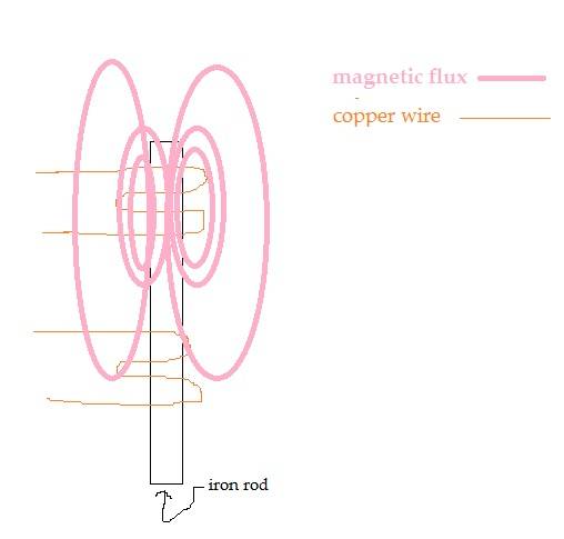

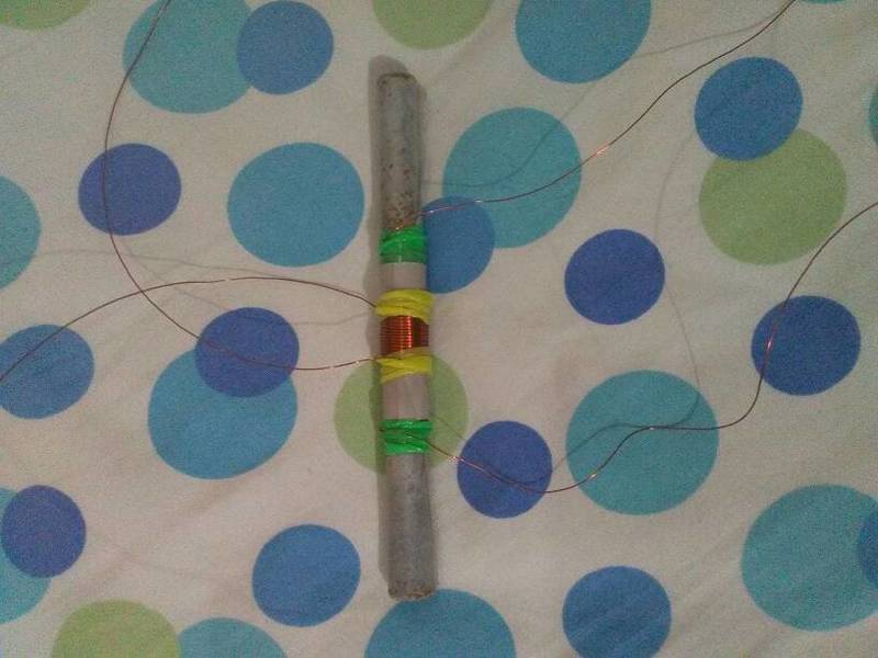

I am a student of class 12. I am making a transformer for a project. I took an iron rod about 3 inches long and cross sectional area about 0.5 square centimetres as the core. The primary coil has 100 turns and the secondary has 25. I used an ac source of 16 volt. I connected the primary coil to the ac source and measured the voltage across both the primary and secondary coil. I found that voltage across the primary coil is about 2 volt and there is no voltage across secondary coil. I used a multimeter for taking readings.
I'm pretty sure I didn't scratch the insulation anywhere in the wires except at the ends, the secondary is insulated from the primary and the primary from the iron core by polyester paper, the coils are wound pretty tight, the ac source and multimeter are fine (I checked), the core gets magnetised, the connections were made well, the resistance of the wires are not that high(primary is about 6 ohms and secondary, about 3)...i can't see where the problem lies. Please help.

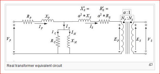

What is the length occupied by the primary coil on the rod? The magnetizing inductance may not be large enough, so it may be drawing a high current and causing a larger voltage drop across the source impedance. Assuming your primary coil is 1 inch long (2.5 cm) , I get a magnetizing reactance of about 8 ohm, which is not that big. If the coil length is about 3 inches, the magnetizing reactance reduces to about 2.7 ohm, which is definitely very small and is the reason for the reduced voltage across the primary.

The primary occupies about an inch and a half

I did. The source voltage is 16
GoodPost said:
I'd connect the source to the secondary and measure V across the terminals of both sides. I may end up with a clue.
Did that too. In that case, voltage across secondary is 0.5 volt and there is no voltage across primary
What's magnetic reactance?
Ruby_338 said:
What's magnetic **magnetizing** reactance?
The reactance responsible for establishing magnetic flux in the core.
In this case, it is the self inductance of the primary coil. You have no of turns=100, area of the coil=0.5 sq cm, length of the coil=1.5 inch, and relative permittivity of iron=1000. Inductance L=μ0μrN2A/l. The inductive reactance then becomes XL=2πfL, where f is the supply frequency (50Hz I assume). With an inch and a half long coil, magnetizing reactance is around 5.3 ohm. You should check the internal impedance of the source. At least check the internal resistance using a multimeter.

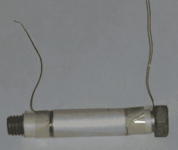

Can you attach a photo of what you have constructed?
https://www.physicsforums.com/attachments/110502.gif

He would get a better transformer if he reduced the current on the coil by winding a longer length of wire. And/or fixing the current from the supply transformer. I get that.
Would he also get a better transformer if he wound the primary on the clamped iron rod in Jim's picture and the secondary around the back of the C-clamp? That looks more like the transformers I see.
That didnt work either. Besides, the project is to make a rod transformer. Maybe i should just make a new one :)​

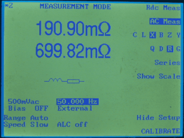

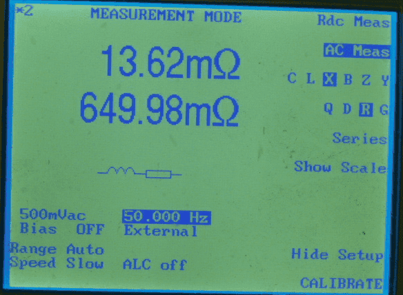

Looking at your photo I'd say that any flux in the primary does link with the secondary and you should therefore get the correct transformer action.
What it seems to me is in question, is how much of your measured primary voltage is inductive and how much resistive? Since you have not many turns and a poor magnetic circuit, the inductance may be quite low compared to the resistance.
Guessing at copper wire of about 0.25mm diameter (based on the 100t primary occupying 1/3 of the length of the 75mm rod) and 100t around a 5mm diameter bar being about 1500mm of wire, I get a resistance of about 0.5Ω.
For an air cored coil, the inductance is only about 5μH, and the iron bar I think would only about double this, giving a reactive impedance of 3mΩ at 50Hz, over 100 times less than the resistance.
So if you are measuring 2V across the primary, 99% of that is resistive and only 0.02V is inductive. Step that down 100:25 and you are only looking at 5mV induced in the secondary. But I'm surprised you detect nothing, unless you're using an analogue multimeter.
E&OE: It's late, I've guessed most of the variables and my method is very rough and ready. But I'm getting an inductive reactance much smaller than the resistance. Try checking it yourself and see what you come up with. Or measure the resistance of your primary and the current through it, then calculate the values.

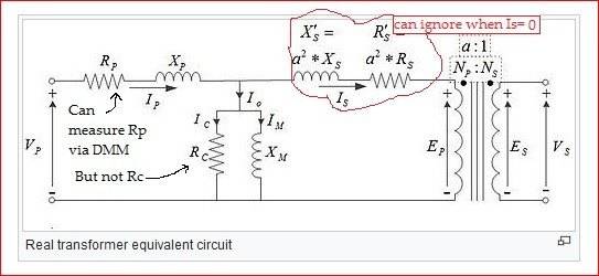

You need to add a known resistive Load and measure the voltage dropped when it's connected to the supply.

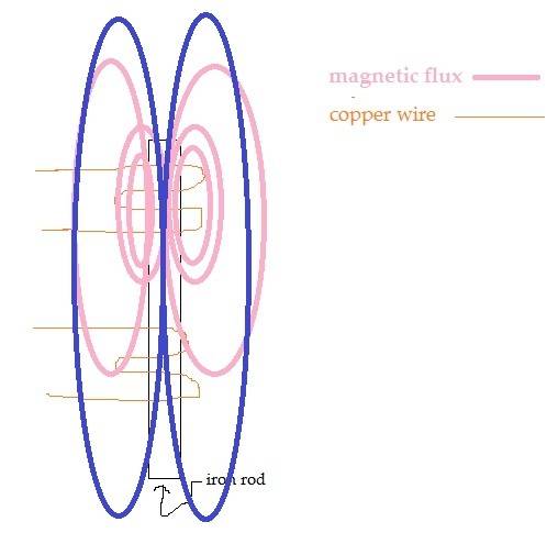

Rod transformers don't work at all well, here's why
It's really difficult to push magnetic flux through air.
So not much of your flux makes the long round trip between the coils and you get not much coupling.
To demonstrate that point is the only reason i can think of for this exercise.
Winding your primary and secondary right atop each other will give you better coupling. I'd hold two strands of wire and wind them at same time, that's called "bifilar winding" ..
Still, with half your magnetic circuit being air it's going to be a feeble transformer. That's why they'd gone to closed loop cores by 1880's.

  • #31
I wasn't counting the flux lines, it's their distribution that doesn't look right. Insertion of the iron core should bring a concentration of field lines with some emerging from the ends of the rod.
The pattern in your image looks appropriate for an air core.
  • #32
You're quite right
sorry , N.O. i thought you were teasing me about the primitive drawing
My thinking is iron core roughly doubles the flux density in its vicinity
because around any loop that traverses it, roughly half the path is low reluctance iron and the other half remains high reluctance air
so yes of course replacing my cardboard core with an iron one should add a few lines to my sketch, like this blue one,
and roughly double the number of purple ones.
I've done that experiment on a 12 foot long coil. We too were surprised flux only doubles.
Thanks for your sharp eye !
PS i removed the snickering kitty
Likes NascentOxygen

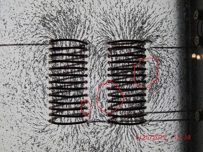

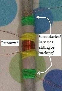

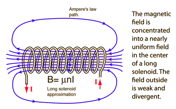

Re. #30 and #31 of Jim and NO : my understanding was that a solenoid had a uniform field inside and nearly all the flux passed through the ends, as shown on the hyperphysics solenoid page or
This would seem to suggest that if the secondary were wound on top of the centre portion of the primary (as shown in Ruby's photo), then all the flux (caused by primary current) would link both coils irrespective of the core or bifilar winding. (OTOH, perhaps not all of the flux due to any secondary current would link the primary, as the secondary is much shorter. But I (we?) haven't got that far yet.)
Re. #32 Jim, I agree with the nearly doubling of flux for any decent permeability core. The length of the air path is nearly halved and the air contributes nearly all the reluctance.
Meanwhile I've found an 8mm bolt and a couple of metres of copper wire and made my own transformer. It was about 1.7Ω primary, but I didn't have time to measure the reactance, because, my step-daughter decided to have her son a few days early and I've been whisked away to do something useful instead of playing with my toys. At least I've got my laptop, so I can keep up with the chat.
agreed. nearly all but there is leakage flux , integrate h dot dl around any single turn ?
https://sharepoint.umich.edu/lsa/ph...et Library/Two solenoids, B-field_5H15.40.JPG
I didnt read his photo that way
i take yellow tape as underneath primary and green tape as underneath two halves of secondary.
But i didnt think about hooking secondaries in series with turns all going same direction...
Might that be another trouble..?
