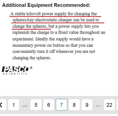

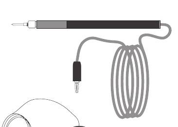

Albertgauss said:
The purpose of this post is to try and obtain something like the "Charger" in the Pasco Coulomb Apparatus ...
The charging probe is basically a multimeter test lead.
The charge is transferred from the power supply that the "charging probe" is connected to. From page 7 of the PASCO ES-9070 User manual (red underline by me):

1000 nC can't be correct. At 1.5V the capacity would have to be 666 nF. In reality however it is around 20pF. Are you sure that all parts of the experiment - including the capacitor and the coulombmeter - were completely discharged before you did your measurement? Also, all plastic objects should be kept at a safe distance since they are often charged and can interfere.
There is a simple way to always transfer the same specific amount of charge. All you need is a metal sphere on an insulating handle and a constant high voltage source. Since the sphere has a constant capacity it will always pick up the same amount if charge if you touch it to your voltage source. You can then touch the sphere to whatever you want to transfer the charge to.
