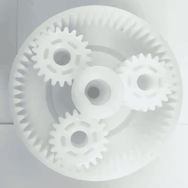

I would say some plastics planetary gear stuff would be ideal for you.
You would need to 3D print a proper housing, of course.
