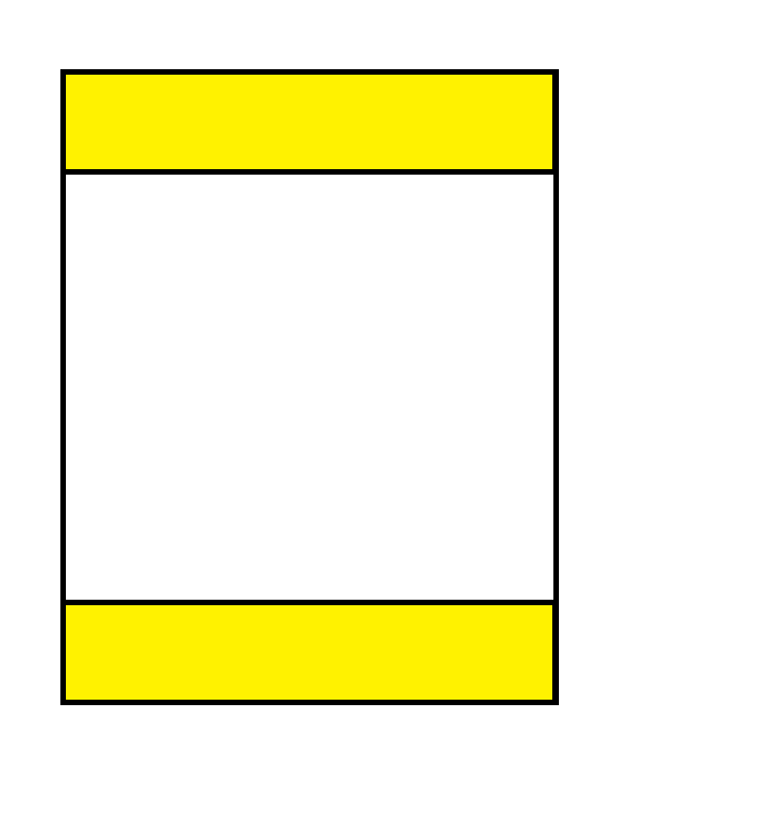

Hello,
I usually wind induction motors. I found folding their insulation papers are so boring to me. So, I would like to make a machine that eases my job. Please see the attached file. The paper's dimension would be something like 80cm x 120cm. This machine must be able to fold the yellow areas onto the white area. The width of each yellow area can be at maximum of 10 cm.
Could you please give me suggestions of what parts on the markets I should look for? It doesn't have to be fancy. It could be operated by hands instead of motors.
Thank you

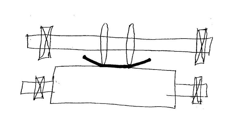

I spent a summer working in an electric motor rebuild shop a long time ago. I sort of kinda recall that they had a slot insulation creaser that worked like this sketch:
A rubber faced bottom roller is about 2" diameter. The top shaft has a pair of steel creasing wheels about the same diameter. The creasing wheels are pressed into the rubber enough to get the desired amount of crease. The creasing wheels are not sharp like a knife, the tips have a radius on the order of 0.1 to 0.2 mm. I do not remember if the two rolls are geared together, or if one is driven while the other is driven by friction. Paper side guides are not shown.

Thank you guys for your ideas. These are very helpful! I will build the machine based on the three version of you guys. When I finish building the machine, I will let you know. :)
