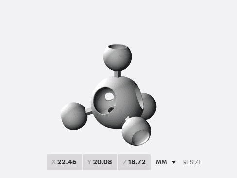

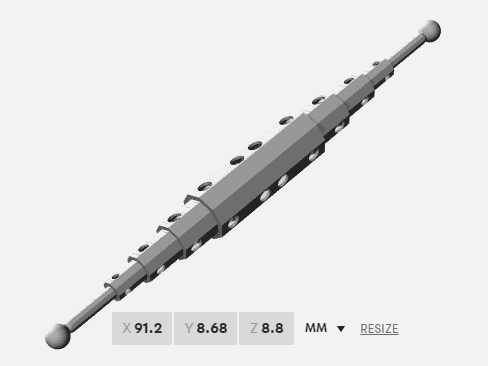

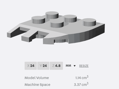

I know this works because I did it myself (see my prototypes below).
Go on to a 3D printing site such as Shapeways. Ask for a designer. I got 4 or 5 offers. Describe your device. Have them design it and pay them for it. Have it printed and ensure it works to your satisfaction. Then take it to an ME.
I had only sketchbook drawings to start, and now I have a working prototype, which I tweak as-needed.
I was surprisingly cheap. I paid about $50 at a time for files. This will be both cheaper and more effective (because you can iterate your design until it does exactly what you want)
I can help you navigate the process if you'd like.
