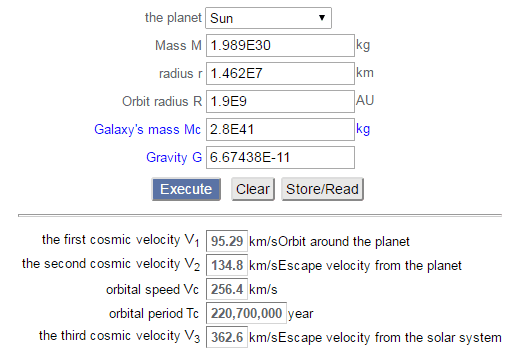

Hi, gneil.
I had to add the numbers back into the fields above the line, so it's not quite a screen shot; the numbers are as on the screen.
the planet Sun
Mass M 1.989E30 kg
radius r 6.96E5 km
Orbit radius R .0977 AU [21 solar radii, 14,616,000 km from surface]
Galaxy's mass Mc 2.8E41 kg
Gravity G 6.67438E-11 [the negative sign is on screen. Is it correct? No units given. Gravity that tiny a force? When I cleared the calculator, then reset it to Sun, it cleared the GravityG field permanently. Total lack of anything in that field did not change the outcome, below ]
the first cosmic velocity V1 436.7 km/s Orbit around the planet
the second cosmic velocity V2 617.6 km/s Escape velocity from the planet
orbital speed Vc 35,760,000 km/s
orbital period Tc 8.138E-8 year
the third cosmic velocity V3 50,570,000 km/s Escape velocity from the solar system [and that's many times the speed of light--can't be correct, can it?]
The third cosmic velocities of the Sun and the moon are calculated as the escape velocities from the galaxy and the Earth respectively.

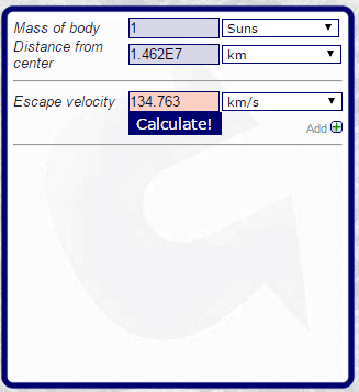

"134.8 km/s." is that escape velocity from the sun (what I need) or from the solar system? http://www.calctool.org/CALC/phys/astronomy/escape_velocity says 138.74 km/s "escape velocity," but it doesn't exactly say whether from sun or solar system, though I gather it means the sun. That's close enough to your number for corroboration. Unfortunately that calculator doesn't tell me anything else.
"This is using a value of 132712440018*km3*sec-2 for the GM (also called the gravitational parameter μ) for the Sun, and 6.9599x10^5km for the radius of the Sun." Is GM the same as GravityG in the Keisan calculator? When I input that number in that field, the first, second, and third cosmic velocities change to 1.947E+13; 2.754E+13; and 1.617E+13 respectively. That's 1.617 x 10^13? That can't be right

It would appear that when you selected "Sun" for the planet it filled in some numbers having to do with treating the Sun as a "planet" orbiting the galaxy center. I checked and it fills in 1.9E9 AU for the orbit radius, which is far to large to be anything but a galactic scale measurement. Apparently you chose to make that field your ship's orbit radius (the 21 solar radii). Not good. You want to use the "radius r" field for that.
The Gravity G value is Newton's gravitational constant. It is correct. Yes it's that small. I suppose what you see in that field when it appears is the default value used. Presumably you have an opportunity to play with it. I didn't check that.
Here's the output I got when I used the "radius r" field for the ship's orbit:
The orbital speed and orbital period values are consistent with the Sun's speed and period of orbit around the galaxy center. The final escape velocity shown would be for escaping the entire galaxy, not the solar system. The software is not very well done if it doesn't make these things clear.
I plugged in your ship orbit value into that calculator and it returned:
I don't know how you obtained 138.74 kps.
Anyways, 134.8 kps is close enough for what you want as the solar system escape speed. The Sun's mass dominates.
GM is the product G multiplied by M, where G is Newton's gravitational constant and M is the mass of the Sun. It turns out that this product, GM, is actually a more accurately known constant than is G alone! This may surprise you, but G is a very small constant and notoriously difficult to measure accurately. GM on the other hand is pretty large and can be accurately determined by closely tracking a space probe's orbit over time.

So: I'm going to assume that I leave perihelion, and lose my engines, @300kps (unless you see domething wrong with that number); that I can get away with coasting for three days while I mount the comet thrusters; thrust continuously for three days at 2/10g to gain some distance from Sol; then drop to 1/20g 12 hrs/day for ~40 days while I repair the main drive. Get drive and inertial reduction coils back on line in time for a gravity sling around Jupiter, and with inertial reduction, main engine and comet thrusters all working, I can get 3g all through my burn around Jupiter.
If it's 57 million km (Mkm) Sol-Mercury (mean orbit; http://www.universetoday.com/15462/how-far-are-the-planets-from-the-sun/ ); / 300km/s x 3600 sec= 52.8 hrs unpowered but also no drag from Sol. If I wanted to subtract out deceleration from Sol's gravity--which apparently lessens--as the square root of distance from source?--rapidly as you gain distance, what would that equation look like? Would that stretch 53 hrs to ~72?
779Mkm (to Jupiter) less 57 = 722Mkm, 4.8263 AU. Let's see if I can drag and drop this here: Yep!
