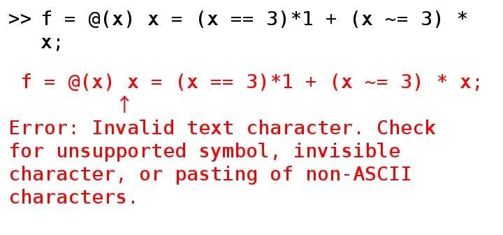

I don't know if this is common for anonymous functions, but I found that whitespace is illegal, unlike java or any other programming language. In MATLAB mobile:
Works correctly with whitespace removed.

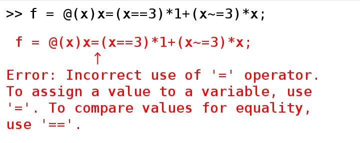

Another thing: the "x=" part is also giving an error:
Other than that, the result is coming fine.
I appreciate your reply. Thank you. I have had the error and tried permutations trying to figure out wth. Thanks.
Likes Wrichik Basu

Mark44 said:
So, Wrichik, is this what works?
Matlab:
f = @(x)(x == 3) * 1 + (x ~= 3) * x
Nope, the space is still giving an error:
Could be a bug in the app. I don't have Matlab desktop version, so I cannot confirm.

Well, that sucks... There aren't many programming languages that throw an error because you have included a space.
It is quite frustrating, and I don't have an explanation. I tried all possible combinations, and this is the one (at the bottom) that was evaluated correctly (mark the spaces):
I wonder if the "invalid text character" isn't a space but some other character that looks like a space? Or an invisible character that is there as well as a space?
could it be that the multiplication is attempting to be applied to a logic result.
That would be worth investigating.
I doubt this very much. In matlab, true has the value 1 and false has the value 0.
I directly copied from here and pasted there. Should that cause any problem?
That is most probably the problem. Matlab has no problem with spaces (ASCII code 32), so it must be another character that is copied and pasted.
You've got it right. But I copy-paste from the MATLAB website as well, but that doesn't create a problem. How is this possible?
The two web sites might be formatting text differently, with one using non-printing characters like &nbsp (non-breaking space) or similar.
I'm going to guess that my 2nd stab at it will actually work, with the extra spaces added for readability not affecting anything.
Matlab:
f = @(x) (x == 3) * 1 + (x ~= 3) * x
Likes Wrichik Basu
One more thought: the text inside a "Code (Matlab M)" box on this forum is coloured, which means there is colour information as well as text. When you copy and paste into Matlab, the colour information may be corrupting the text (Rich Text?).
Likes Wrichik Basu
