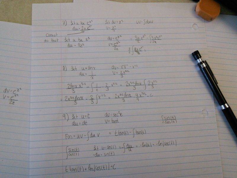

Find the integral of z^3 e^z^2
The integration by part formula
I have no idea what to do, I'm just turning in circles

Well, show us your latest turn around the circle in working out this integral. You may have overlooked something simple.
Some integration by parts problems require using it a few times :D

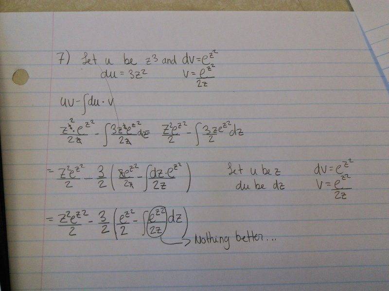

Here's my attempt that doesn't work...
And another one
If dv = e^(z^2), v is not e^(z^2)/z^2. You cannot simply reverse the chain rule going backwards because if you take the derivative of that, you'll get something different from the quotient rule.
So when doing parts and one way doesn't work, what to do next?
Wel, normally you try going the other way around, but it still doesn't work as shown in the first picture...
If you are going to make dv = ez2 dz, then u = z3.
However, it is easier to integrate ez2 dz if you analyze it first using a u-substitution for z2.
Hint: you may not want to make u = z3 for this integral.

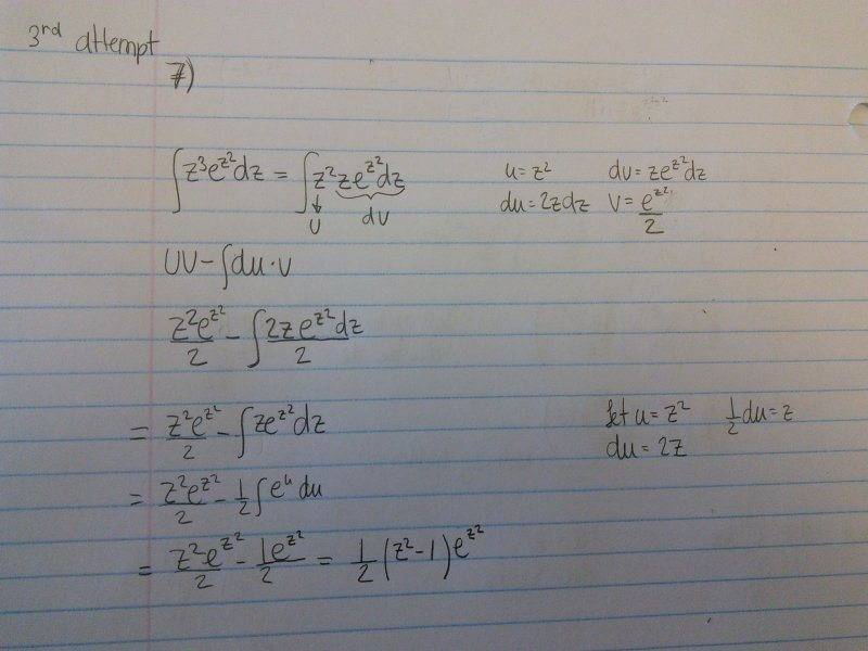

Oh ok! I think I get now! Thank you to everybody on this thread for your help! I'll try that!
And when you post again, @Airp, be sure to include at least some of what you have tried.
This is what I finally did! Thank you again!
Also, it's better to include your work right here in the form rather than an image of it. Everything you wrote on paper can be done right here using LaTeX, which isn't really that difficult.
Here is one of the lines from the last image you posted.
$$\frac{z^2e^{z^2}}{2} - \int \frac{2ze^{z^2}dz}{2}$$
