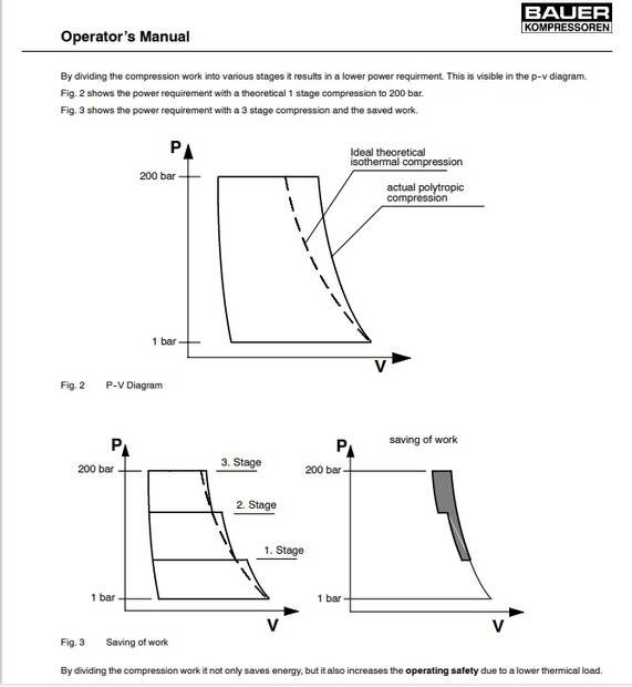

Note that volumetric capacity of most compressors is given for less than 200 bars.
The higher the output pressure to reach, the higher the temperature and the less the mass that goes into the tank for each stroke.
Fill the tank with a suitable liquid and use a pump if at all possible, or minimum amount of gas, if not.
Copied from
https://www.bauer-kompressoren.de/f...ist/serviceunterlagen/betreiberhandbuch_e.pdf
