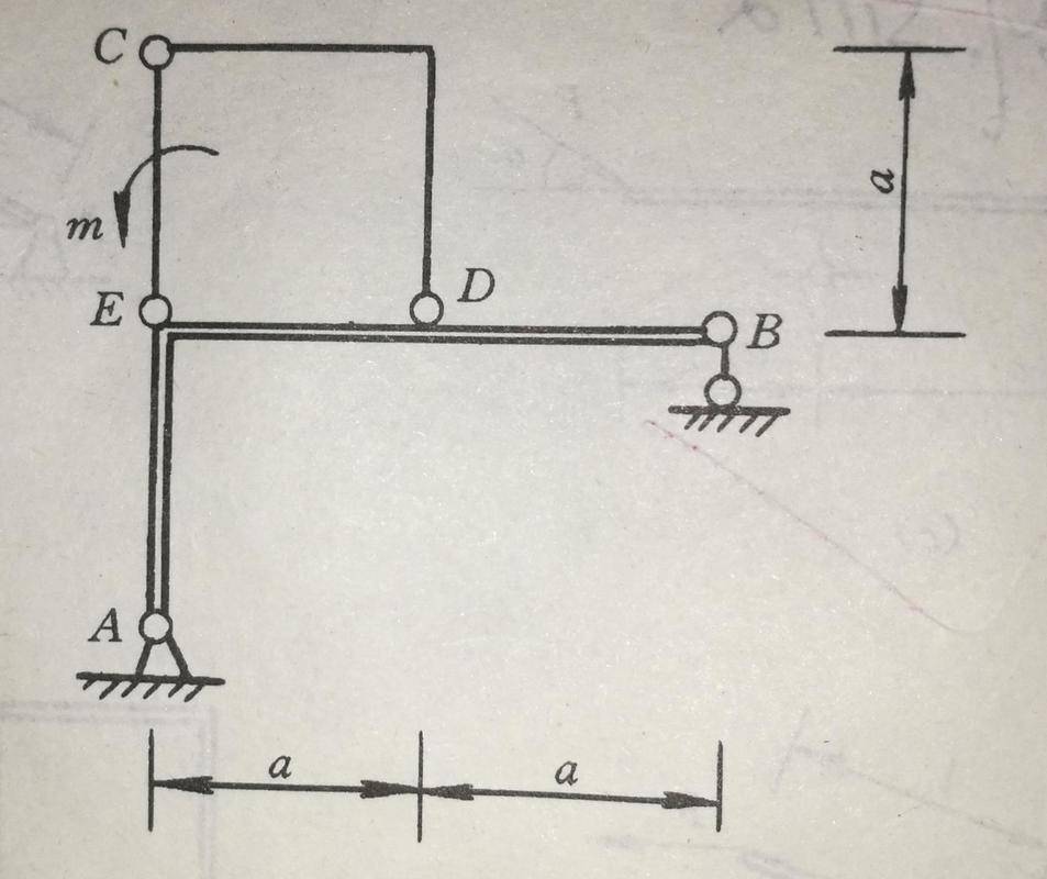

1. The illustrated structure is affected by a known couple, and try to figure out the restraining reaction force of the hinge A and hinge E.
We should analyse ECD instead. Since arm CD is a two force members, so N(C) in in the direction where CD connects by these two points. The distance from E to diagonal CD is a/√2. So we have N(C)=√2 m/a. Because N(C)=N(E) ( N(C) and N(E) together form a couple), N(E)=√2 m/a.
Where did I go wrong?
I agree with your reasoning and answer. Who says it is wrong? What other answer is given ?
The official answer just doesn't match mine.
Ok, but what is the official answer?
R_A= \frac m 2a, R_E=\frac \sqrt {{2} m} a,
Your latex had some errors. In fixing it up I arrived at
Kile said:
##R_A= \frac m{ 2a}##, ## R_E=\frac {\sqrt {2} m} a##,
But that makes the reaction at E the same as you got, so perhaps you meant something else.
Yes. You did it in the right format. Do u know how to get this official answer?
As I wrote, it's the same as your answer, just written differently. They both say ##(\sqrt 2)(\frac ma)##.

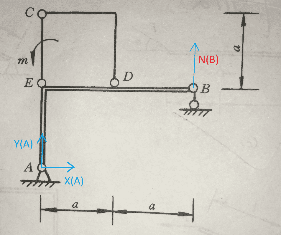

How did u get ##N_A## ?
Can u draw a diagram to illustrate?
I thought we were discussing NE.
For NA, take moments about the other hinge.
How can u get it? can u help me out?
Consider the whole frame as one body. If you take the B hinge as axis, what moments are there?
Because point B has a pulley on the ground, ##N_B## is vertical.
Choose A be centroid
$$\sum m_A (F)=0, ~2a N_B + m=0$$
$$\Rightarrow N_B=\frac {-m} {2a},$$ So it's downward.
X-axis, $$X_A=0$$
Y-axis, $$Y_A=0 $$ $$N_B + Y_A=0$$
$$\Rightarrow Y_A= -N_B = \frac {m} {2a}$$ So ##Y_A## it's upward.

Kile said:
View attachment 240415 Because point B has a pulley on the ground, ##N_B## is vertical.
$$\sum m_A (F)=0, 2a N_B + m=0$$
X-axis, $$X_A=0$$
Right... except, strictly speaking there could be equal and opposite horizontal forces at A and B, making the problem indeterminate.
You mean $$X_A = X_ B$$ It may not equals to 0.
We just can't calculate it from the information already given.
Is that what you are trying to say here?
Right, except XA=-XB. And if not zero then it changes YA and YB so as to balance the torque.
