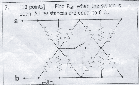

We need to find the total resistance of this circuit but I'm not sure whether the circuit will shorten or not.
(I don't even have any idea on where I should start cause it looks so different from the other ones.)
Can someone also give me tips and tricks in simplifying ladder type of circuits because I'm having problems when the circuits are not simple looking .
KhanAcademy only shows me how to solve simple looking circuits unlike this one.
For the pic ^ is the total resistance 2 ohms?
Every 3 resistors (Parallel) = 2 ohms
Upper left & Lower left (Series) = 4 ohms
Upper right & Lower Right (Series) = 4 ohms
Left & Right (Parallel) = 2 ohms
(SERIES) R(T) = R(1) + R(2) + R(3) ... R(N)
(PARALLEL) R(T) = 1/ [(1/R(1)) + (1/R(2)) + ... (1/R(N)) ]

Your analysis of the second circuit looks fine and you've arrived at a correct result.
For the first circuit, go back to the definition of parallel connection and see if you can spot any parallelization opportunities. Sometimes it can help to use different colored highlighters to color the individual nodes, that way you can quickly spot components that share the same pair of nodes since they connect to the same pair of colors.
