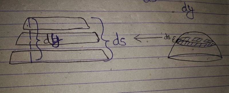

Hey everyone,
I'm studying for my physics and came across a question for the COM of a hemisphere.I made my attempt to calculate the COM.
I tried to calculate the y coordinate of COM this way,please go through it-
But,I am unable to reach the correct result.Please help me to proceed further!
I will be thankful for any help.

##dy## in your drawing is not actually ##dy##. ##dy## would be a vertical line. That angled line ##ds## is longer, do you see that? Use ##\theta## to find its length. Then I think you'll get it.

Thanks but I can see how dy is a vertical line!
Can you send a rough diagram showing that?

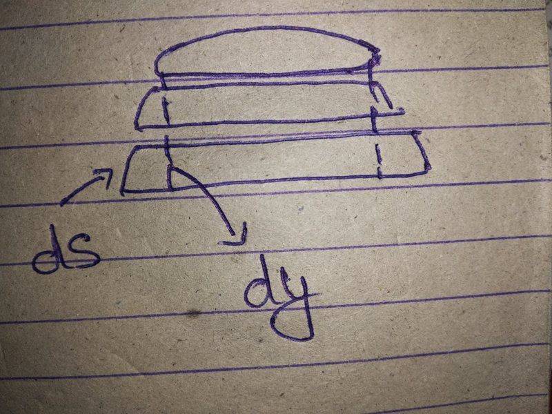

##dy## is the thickness of the disc. ##ds## is the length of the edge. Do you understand?

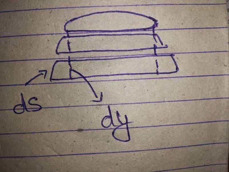

See the image.
These are the horizontal slices of the element ds as shown in the pic.
I think I have made the diagram correct as dy is the horizontal thickness and ds is the thickness of the edge.
So,if we see logically then it would be incorrect to calculate the area of the element this way, area of the element= 2*pi*y*cot(theta)*d(s) as the thickness of edge of each slice of the element marked on the hemisphere is different.
So calculating the area of the element this way must be wrong,Am I correct?
I think you mean 2πx (the radius is horizontal in the diagram) and it should not be cot. ds is the hypotenuse.
