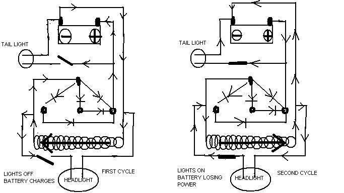

Ok, I just drew it. I hope it's clear enough. The tail light also represents the others, the sign, brake, and horn. But I haven't checked if the battery losing power with the tail light off.
I used the 6 amp diodes. It became very hot in a few minutes, so I made a parallel of 20 diodes to ease the current and reduce the heat, and many still fried after a few days.
Btw, the generator pulse produces about 40 volts AC when roared. Not sure about the amp, I have no amp meter.
And I use a 100 watt bulb.
I have a lot of questions / comments. Please bear with me and read them.
Are those little arrows on the wires current direction? The diodes would be the arrows with the bar across, i guess.
I am a bit confused about what "first cycle" and "second cycle" refer too - as the switch is in different positions for each picture. The circuit describes itself - without needing to show what happens on each half of the cycle; the current arrows are superfluous - or worse.
There seems to be only one diode that is actually operational in the block. Strange.
There appears to be no path on the diagram for current to flow from the battery around the headlamp so I think there is something seriously wrong if, in fact, the battery is discharging through that lamp.
I can't believe that the circuit arrangement you have drawn is as it should be. You may have inherited some 'modifications' by someone who didn't know what they were doing??
The diode block is weird - it seems to have two series diodes in parallel with one diode. Are they normal diodes?
What is your reason for thinking that it is supposed to be just a half wave rectifier? You appear to have enough diodes for a bridge rectifier which would make much more sense. It would only require a slightly different way of connecting them. Are you really really really sure that you have what you think you have?
What are the volts across the bulb when switched on and the engine turning at a reasonable speed? This is relevant because a bridge / fullwave rectifier will give you twice the volts of a half wave rectifier. SO you may just not have enough volts to be charging your battery with your circuit when under load (the generator may have been designed with a bridge rectifier in mind). The tail light would be draining it when the headlight is on.
One last question - does the generator get hot when the headlights are on?
It's ok. And I apologize for the arrows. lol. I'm used to it on the lines.
The first and second cycle, wrong wording, sorry. Maybe first half and second half are the correct ones.
And I also drew the "second cycle" to show the currents.
The modification I know was the one I made when I changed the windings, and this was what made me asked the first question. I've been checking the wires today and it seems that the factory didn't use normal wiring. It seems to be reversed somewhere along the way. I've found the tail light wire on the switch was the ground wire, not positive as it should be. And from what you said here, it seems that you also see no problem with the currents in every direction, so I will focus on the wiring.
The rectifier, I think they're normal diodes inside, and I think it's half wave since there's only one input line on it. I've never opened it, but I know how it works. The first output goes to the headlight, the second goes to other lights, the third goes straight to the battery. If the headlight and/or other lights are not turned on, all the power goes to the battery. It's how it works.
The generator, there's only wires inside. I know it since I did it myself. lol. I haven't checked the volts with the bulb on, but I've checked it directly and when the machine roared, the peak is about 40 volts.
The last question, I can't tell. The generator's inside the machine block, so I can't check it.
Btw, I don't mind being asked lots of question, as I myself ask a lot. :)

If you haven't looked inside the block then how do you know what's inside? Is there some documentation with it?
Headlights don't need rectification so, as the diagram shows, they are fed directly off the coil. With no load on it, the coil could have (and does have) loads of volts but that's pretty irrelevant. What counts is the volts it can supply under load. You would normally expect to have enough output for the generator to just charge the battery when running at tickover (even with the lights on). This means that it just could be essential to use a bridge rectifier circuit as it gives twice the dc volts. I assume that you wound the coil with as many turns as possible of the original gauge of wire (?) so it should work as it would have done originally and supply the right volts for the original design.
I remember having a BSA Bantam (150cc) in 1966 (it was ancient when I bought it too) and the battery terminals became disconnected and the sidelight / backlight filaments all burned out as the volts soared way above the required 6V.
You seem not to be picking up on my comments about the diode block and how I think it is dodgy in some way (not how I would have ever done it because the design appears to be a bit 'nonsensical'. If we were dealing with a simple half wave rectifier then all we should have is one fat diode - not this odd network of diodes. Neither head or side light need DC. Are they encapsulated totally or are they soldered to tags inside a block? Could the arrangement have been tampered with? Any chance of a photo and or a component number?
Could you borrow an ammeter from somewhere to find how much the battery is actually charging?
I really want to get this thing working now!
The block? If it's the rectifier, I checked the directions of the current and drew it. And if it's the generator, the coil, because I did the winding.
And the current headlight doesn't need rectification, because I made it so. Originally it used the second (middle) terminal.
I will check the volts again when I've done the wires and switches. And yes, I did wind as many turns as possible to get the most of it, and I killed several bulbs because of it.
And I don't understand "not to be picking up on my comments..." Would you please elaborate? I'm not of english speaking country. I read well enough, but I guess many times, just like what I do with "elaborate." I'm not really sure of what it means, but I feel that it's used to ask someone to explain.:)

Re "picking up comments". Yes, it was a kinder way of saying that I don't think you understand the significance of the bridge rectifier problem. :smile:
If you have wound the coil to match the original then it should be doing what the last one did so that's out of the area of worries, I think. It should be something like the original, though. It's not just the volts that count, you know. Ideally, the winding should be designed as a compromise between getting enough volts with as few turns as possible - so the wire can be thick enough to deliver the current without getting too hot. It's a matter of Matching the generator to the load requirements. Did you use the same gauge of wire - or just chose a gauge and piled as much in as you could.LOL.
There is no particular significance in having a Negative or Positive Ground. Most modern vehicles use a negative earth, though. It would be better for you to have a Negative Ground if you want to add 'modern' electronic equipment.
So tell me about this diode block. You deduced the set up by measuring resistance in both directions between the terminals? Fair enough
Are you sure that the original coil was not centre tapped? That block would imply something of the sort. How old is the bike? What make?
lol. I really did pile as much as I could. lol.
And I had to alter the windings a bit. There were 4 in there, one for the spark plug, and the other 3 for the lights and battery. But 3 windings of that 1.1mm wire killed several 100 watt bulbs, and after I paralleled several bulbs totaling 160 watts without any being killed, I separated one winding for the battery and later I added 100 watt H3 bulb, after killing a few 55 watt bulbs. lol. and this one is the one having problem. The other 2 windings I use for a 100 watt H4 bulb.
That was what I did with the rectifier. And I don't think it's a center tapped coil, since the current flow of the rectifier doesn't match the center tapped rectifier. And the rectifier also have only one input line, while the center taped rectifier has 2.
It's a 1987 Honda, and it may not exist there. I'm from Indonesia, btw.

I've checked the volts under load (battery), and it's 2 volts at idle, 18 volts roared, and about 25 volts top. Do you think it's enough? It did charge the battery well, but now I'm thinking of opening the rectifier and build a bridge system with it. Btw, it's encapsulated, and the numbers gone. And I can't take a picture. I only have a cellphone cam and it's no good.
And the original coil was like: first winding-> turn left, second -> turn right, and third winding -turn left. I had to figure it out since 2 guys did the winding before, but since there was only 2 wires went out of it, I'm sure I did the right thing. I wound it it that way before I decided to separate the second winding.
Btw, I'm not sure about the charging current, but it went over 10 volts.Sorry I forgot it. The coil here, it's like + sign in a circle. The + is the iron, and the circle is the rotating magnet. Some other systems used many little "spikes," many little windings, but mine is only 4.
I have a strong suspicion that the guys who did the last job just got it wrong. If you have three coils in different places around inside the flywheel then they will be producing volts in different phases. Adding them in series as you have done will not get the full voltage from them - they will tend to cancel each other out, in fact. The fact that there are more diodes in your block than just the one also implies that it must be a multiphase system. I am pretty convinced about this and I suggest you look at wikipedia and you'll see what I mean.
If you want the best out of the system then you will need to take outputs from each coil and put them each through a separate diode. You will need to take the other ends of each coil and connect them in common to the ground. This is, effectively, three half-wave rectified outputs from three different phases, which will give far more current and a smoother total waveform.
I don't think that a bridge rectifier would help particularly. You need to be a bit more savvy to get it working properly.
Yes, maybe it was a multiphase system, I'm not sure. A two or three phase system, maybe.I know nothing about it.
About canceling each other, I think it was what happened with the first guy because he wound all three in the same direction, such as left, left, and left. The power flowed in the middle coil crashed the other two, and I'm sure it was why the coil was burned. But if the direction is left, right, and left, the power flows at the three coils in the same direction. It was how I did it, and it worked fine, but the power was too high so I finally separated one coil (the middle) to reduce the power. I can still put them together to get the full power, but it will only kill the bulb.
Btw, I have tested all today, and all worked well. I'm not exactly sure what went wrong, but I think you're right that it was not properly wired. It seemed there was a short somewhere. I relocated the tail light wire and used other source for it and the battery didn't lose power anymore. Thanks. I'd still be checking the rectifier if I didn't meet you.:)
