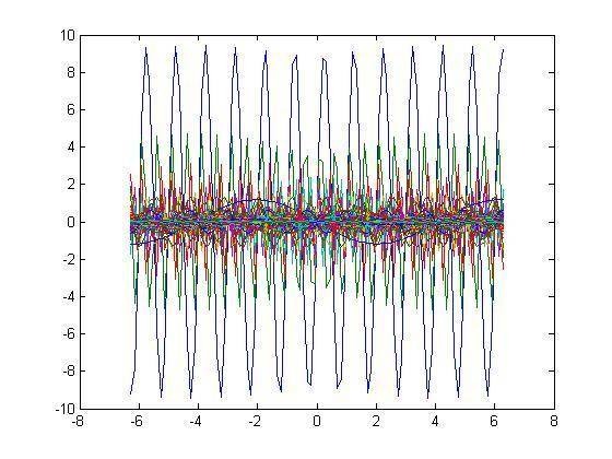

Hi all my first post as I need to seek help!
I have just learned some simple Fourier series stuff and would like to be able to plot my answers in matlab.
Assuming this is correct I was wondering if someone would be able to walk me through plotting this equation in Matlab?
[tex] y=\sum_{n=1}^\infty (3sin(2∏nx))/(n∏)[/tex]
Here is some quick and dirty code to plot this over the domain [itex]-2\pi \le x \le 2\pi[/itex] for n up to 10,000

See the plots in the attached files.

Maybe it is the linespace that is the problem is there a way to evenly space more than 100 points in the domain?
edit: no come to think of it I don't think this will help do you know why this doesn't resemble a Fourier series?
linspace(-2*pi, 2*pi, N) gives N evenly spaced points.
Wow just realized the equation must be wrong as it tends to 0 as n tends to infinity which should not happen.
So where did you derive the equation from? It sounds like you need to start over.
yeh it was a simple example used to teach me about Fourier series. I thought would be fun to see how the series works out but I fear I may have done it wrong
