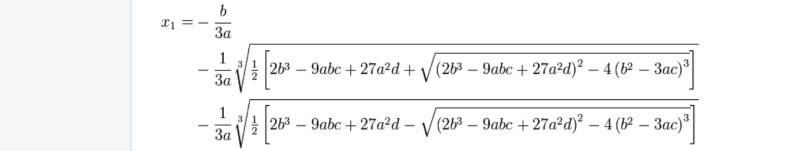

hi i need some help solving this equation for x
y=0.0001x^3-0.0409x^2+4.6716x+280.32
can someone please help me, i really need to solve this for x! full layout would be great

Hello aziqbal. Welcome to PF !
Have you graphed this function? It's a typical cubic function, with a local minimum and a local maximum.
Its y-intercept is 280.32 .
This function is not invertible in general.
The local maximum is approximately y ≈ 443.5 at approximately x ≈ 81.4 .
The local minimum is approximately y ≈ 377.3 at approximately x ≈ 191.2 .
So for any data point with y-value between about 377.3 and 443.5, there are three different possible x values that will work with this function. Note: If y = 400, then x could be about 35.9, 148.0, or 225.0 .
However, if the data were collected for increasing (or decreasing) values of x, then there is a good possibility that you could pick the correct value for x from the three possibilities.
You state that your y-values run from 275 to 475. For any y-value less than 280.32 (the y-intercept) the x-value is negative.

I got the value of x by solving the equation numerically.
Did you even read the rest of my message? It tells you to find x for given y using the EXCEL Solver Tool!

You're solving for the y value as given. For y = 275, the equation becomes:
275 = 0.0001x^3 - 0.0409x^2 + 4.6716x + 280.32
0 = 0.0001x^3 - 0.0409x^2 + 4.6716x + 5.32
Ok that's great!
So basically if I want to solve for zero if I plug my co-efficients into the above equation I should get value for x

OMG I just did 4 pages of Maths and got x to be -42.76!
Could I push my luck and ask if anyone else got a value close to that??
That equation is really tough so many steps I had to split it into parts and do each part individually
aziqbal said:
D=280.32
You need to subtract the value of Y from D. For Y = 275, D = 5.32 .

How many data points did you use to get that polynomial by curve fitting? If you used only those 4 points, it should be possible to get a polynomial which fits those points exactly.
How much round-off is present in the coefficients of the polynomial?

Since it's 4 points and 4 coefficients, you're just solving for the coefficients (instead of a curve fit). The issue seems to be the precision of your coefficients.
Code:
  0^3 a  +   0^2 b +   0 c + 1 d = 280.32
 60^3 a  +  60^2 b +  60 c + 1 d = 437.03
120^3 a  + 120^2 b + 120 c + 1 d = 441.10
180^3 a  + 180^2 b + 180 c + 1 d = 434.34
a =   0.0001094212963
b =  -0.04089583333
c =   4.671666667
d = 280.3200000
y = 0.0001094212963 x^3 + -0.04089583333 x^2 + 4.671666667 x + 280.32

I just got done using a divided difference table to find the coefficient of x3 with a result of 4727/43200000 = 0.000109421296296...
The coefficient of x3 you (aziqbal) used was especially responsible for the errors you were experiencing.
For instance if you find the roots of the equation, 0.0001x^3 - 0.0409x^2 + 4.6716x + 280.32 = 441.10, the middle root is x = 94.0446 .
Simply correcting the coefficient of x3 , thus solving 0.0001094212963x^3 - 0.0409x^2 + 4.6716x + 280.32 = 441.10, gives a middle root of x = 119.837 , very close to 120.
Using rcgldr's cubic polynomial, solving 0.0001094212963 x^3 + -0.04089583333 x^2 + 4.671666667 x + 280.32 = 441.10 gives a middle root of x = 120.0 .
arrghh thanks so much guys, yes i need to round especially the first co-efficient to many decimal places and it works fine then!
