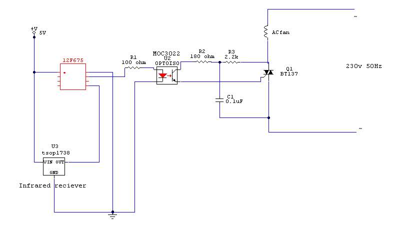

WELL I FINISHED IT,
Remote fan regulator
http://aruna1.web44.net/electronics"
